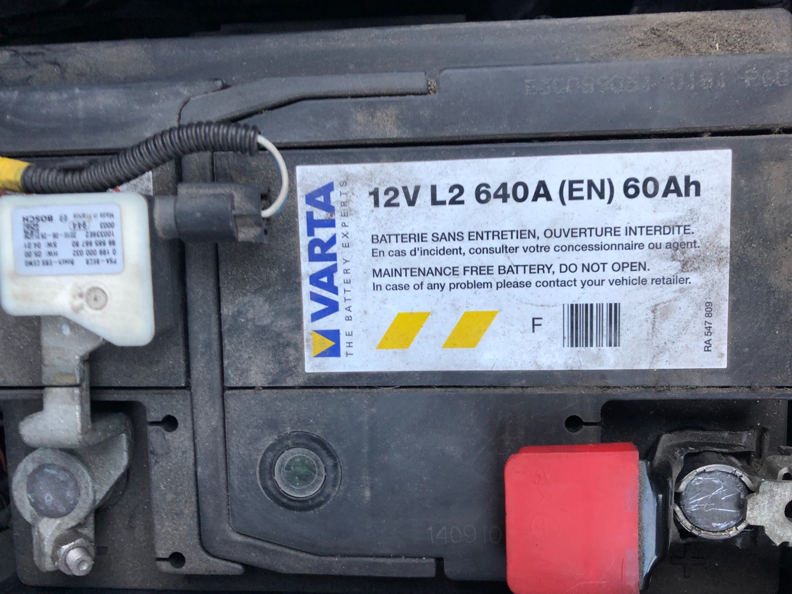

This is the current battery I have no idea how to find the age of it

That might be the original battery. Look at the numbers left of the red lever, 140910 implies 14th of September 2010.
On a positive note, everything is very clean and clear of corrosion!

@Paul-R its been very good looked after and yes looks like to be the original one... i will replace it tomorrow thank you all for all the help <3

That little glass 'window' just below and to the left of the Varta label appears to be showing a green disk. If it is, it 'may' indicate that the battery is still good. Before replacing the battery I would get it tested at a proper garage (some places will grab any opportunity to sell you a replacement even if your part being tested is still good).
