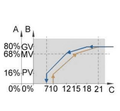

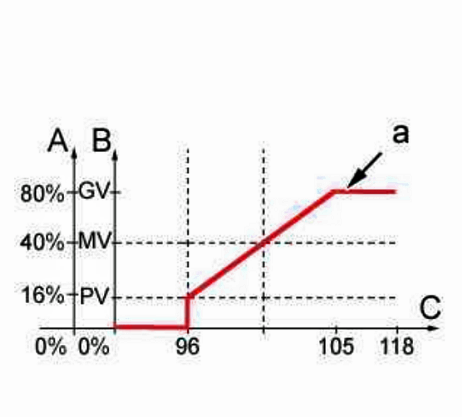

There are 2 graphs, the first to show how the fans operate for Engine Cooling and the second for Air Conditioning Circuit Pressure:
(1) DV6TED4 engines are all equipped with a cooling fan piloted by electronic chopper.
The triggering of the cooling fan for the purpose of cooling the engine is dependent on the coolant temperature as in the following graph:
Key
A Open cycle ratio (in %).
B Cooling fan speed (in %).
" a" Engine coolant temperature alert and lighting of the alert warning lamp.
C Engine coolant temperature (in °C).
(2) As far as the Air Conditioning goes, the required cooling fan speed as a function of the air conditioning circuit pressure:
Key
(A) Open cycle ratio (in %)
(B) Cooling fan speed (in %)
(C) Air conditioning pressure ( bar)
(GV) Cooling fan unit fast speed
(MV) Cooling fan unit medium speed
(PV) Fan assembly low speed

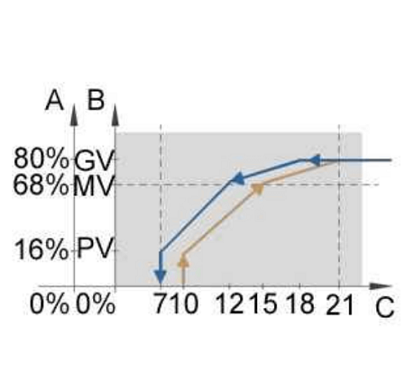

Key
Key
