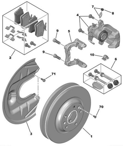

I want to rebuild the calipers on a C6 later this year. And by rebuild I mean beadblast the unit and re electroplate it aswell as new seals etc. My question now is, the electroplating part. When the cars were fresh and brand new, what colour was the calipers? Was it a silvery finish, a dull silvery finish or did the calipers have the yellowish cadmium colour finish?
Then also I checked online, but what manufacturer do you guys suggest for the caliper seal kit as there are loads.....

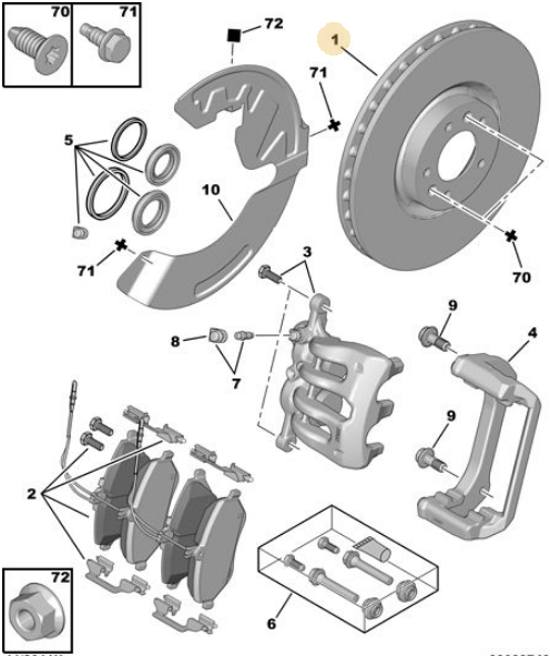

The originals were either Teves or TRW and just tended to be the standard silvery grey colour from what I can see Corne.

These are the TRW brakes at the front then.

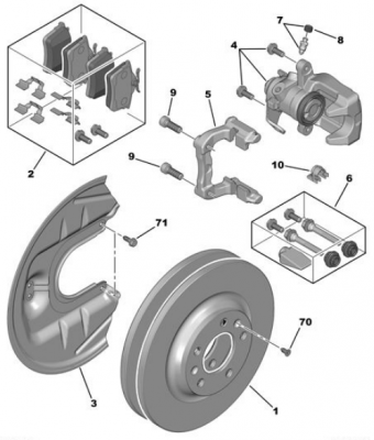

Ah. Great. Will check for rebuild kits. Do you possibly know. The plates (nr 3 and 10). Were they painted black or plated as these are quite bad. So might be worthwhile to get then up to standard aswell.

Yes, these are a rust issue - mine have disintegrated at the rear, and they were ridiculously expensive to replace new and I couldn't source any second hand ones that didn't also look like they would crumble in your hand so have left it. The ones I looked at were black, and had I sourced some reasonable ones, the first thing I would of done was coated them in Hammerite. I may still do when I get round to looking again.cornesoutafrica wrote: 03 Aug 2019, 23:19 Hi Marc.
