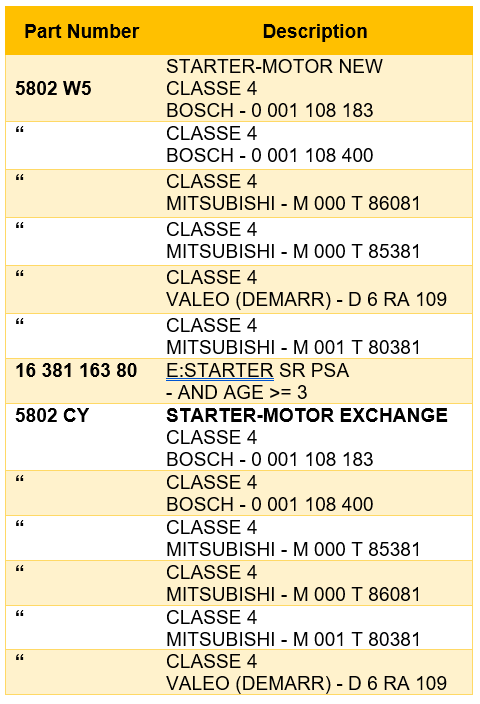

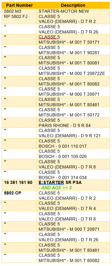

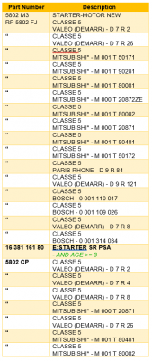

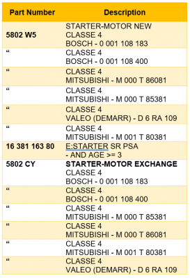

Re: How do I identify the correct starter motor?
Ok, so I've types up the data into 2 tables - PSA part numbers of the left column of each table and the description in the right.
You'll have to click on each to zoom and clarify it, but it may help you with the details. For each part number, there are several variants as you can see, so the part number is shown with a ditto.
Although there's lots of makes listed, there is actually only 1 part number 5802W5 - and this covers both DW8 and XUD7 variants, at £215. So not sure how GSF have got it wrong... This starter is widely used, so there should be no difficulty in getting one - definitely go back to GSF and get it changed. On no account buy an RTX one from Eurocarparts / Carparts4less!!! There's loads on ebay if you input the cit part number, this will give you a picture to look at. Should be 3 mountings 90deg apart, 2 of which are threaded into the starter.
