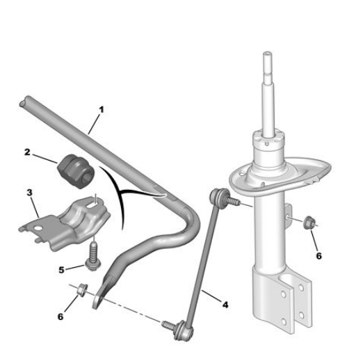

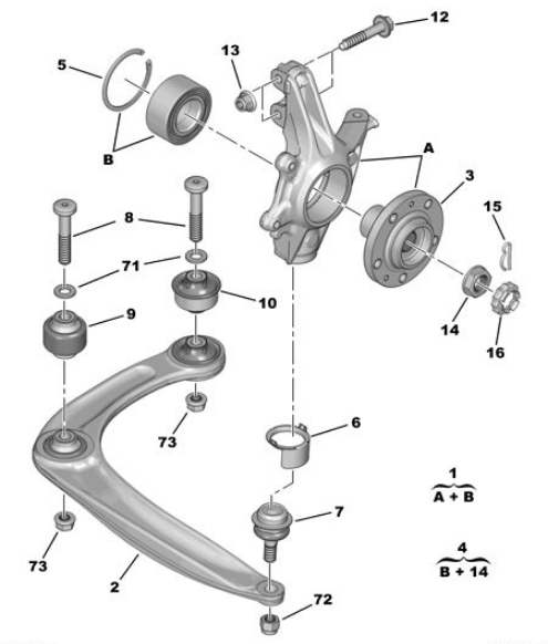

That's why it's important to check all the rubber bushes in the hubs and joints as the it may not always be possible to test them by pulling or pushing them, but when the car is moving the weight and intertia is enough to cause a knock if any are worn.
Drop LinksFront Pivot & Hub
The above are to give you an idea.
