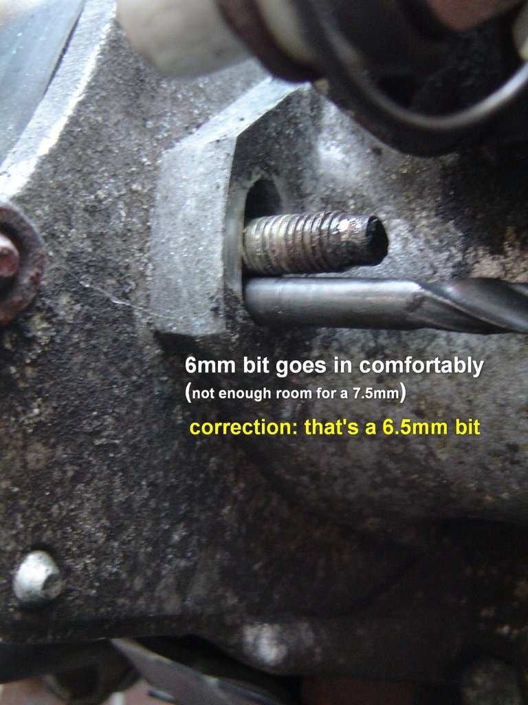

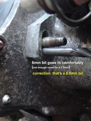

I did make this note about the Injector Pump timing on one of my spare XUD's a while back,
that a 6.5mm Drill bit will go into the 'available movement' on the easiest accessible mounting
Oops, afterthought, might be different as this one's a non-turbo
