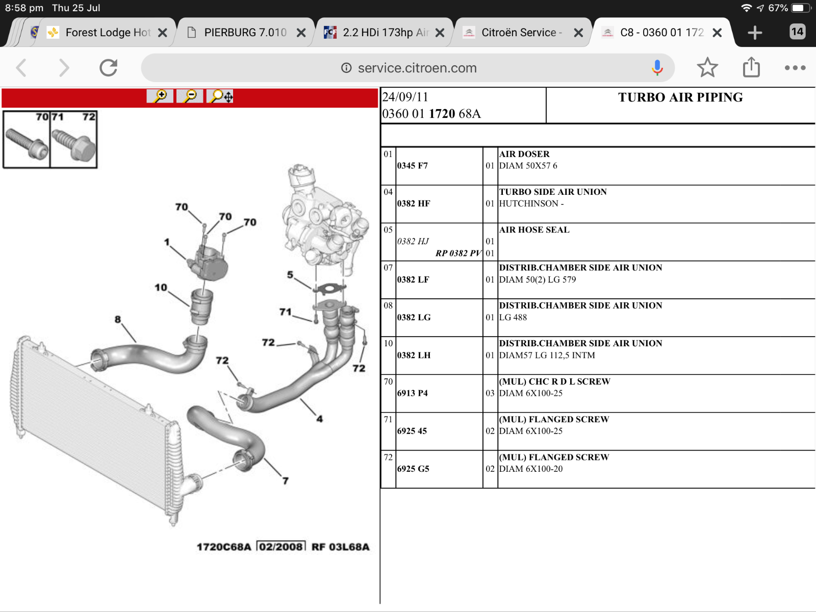

I just wonder whether, if I were to remove the air doser (item 1 in the pic below) it’s possible to clean it or overhaul it in any way.

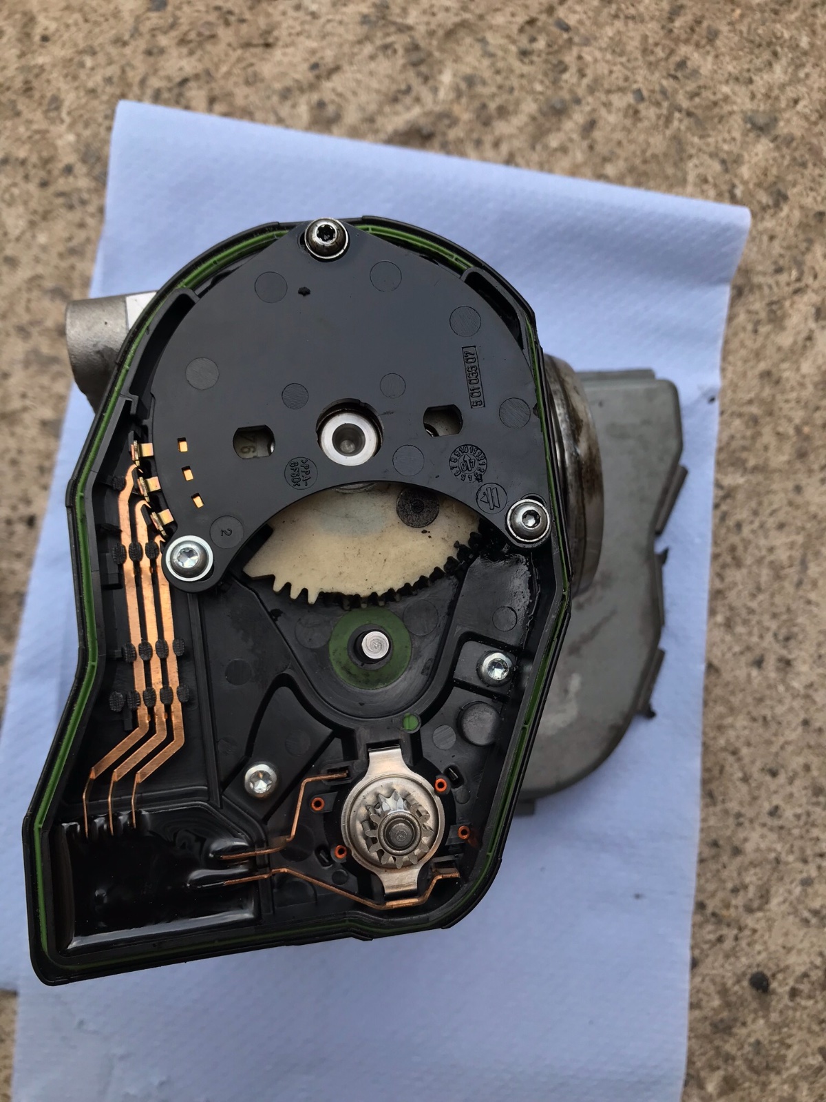

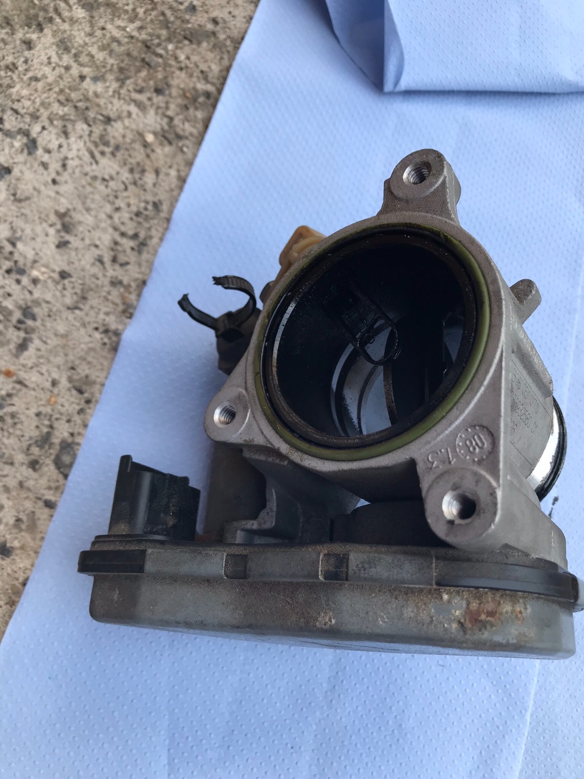

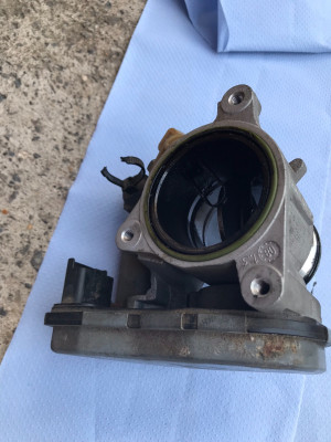

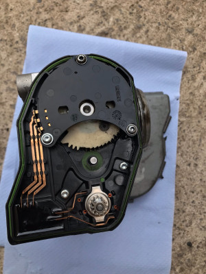

Just in case anybody else is searching this Forum in the future for a similar problem, the problem was indeed the air doser and it turns out that I’m not the only person to encounter this problem on the twin sequential turbo 173 hp 2.2 HDi.
A drive gear inside the unit had worn its teeth away and there is no alternative other than to replace the complete unit. Fortunately they are available from £100 and it’s not too difficult to replace the unit, although access isn’t brilliant.
This is what the outside and inside of the failed unit is like, with a drive gear removed to show the most worn part.
