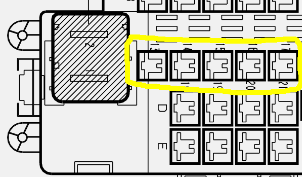

The fuses you need are in the cabin fusebox. Here is a scalable SVG diagram and the relevant fuses - pick one that meets your needs, but when using a piggy back fuse, always enure the accessory fuse is not too high for the equipment you are using as they may supply a higher fuse than needed.
Here are the above fuses which I have highlighted on the extract from the above in yellow:
| Fuse Number | Amps | Equipment |
| F13 | 20A | Heated Seats |
| F14 | 15A or 30A | Accessories Socket or Caravan Socket |
| F15 | 20A | Rear Electric Windows |
| F16 | 40A | Anti-pinch Electric Window |
| F17 | 15A | Audio System |
