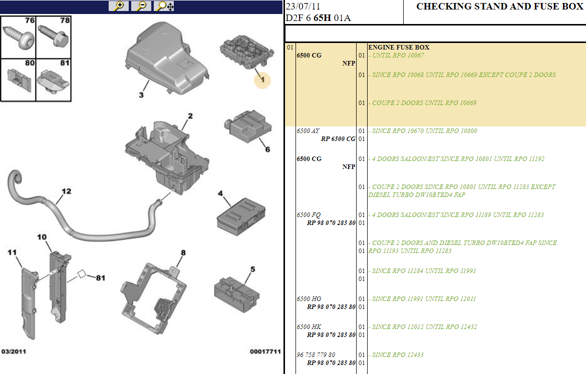

Re: BSM-problems 407
Here's the part number you listed - as you can see your part is for cars to build date 10669 (21/01/2006) and the part number your seller has listed is shown for later models from build date 11189 (28/06/2007).
You can certainly try it, but these also have electronic cards in that talk to the network - so hard to say - you may be ok, but we can't say for sure as we usually stick to the recommended parts for the vehicle and build date.
