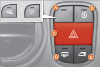

So you have a BIPPER TEPEE (A9) FAMILY SALOON 1.3 HDI 75 STT 5-SPEED PILOTED MANUAL GEARBOX.
As you've discovered, these can be a right pain. They are a manual gearbox and clutch system, that uses hydraulic actuators to change the gears and operate the clutch. When they start playing up they can be a nightmare to repair.
There are lots of conditions that have to be met for the Stop Start function to operate, but cutting out isn't one of them and this should not happen while driving of course. I can't offer any solutions as they are a FIAT collaboration and use hybrid systems.
Until you manage to get it resolved, I suggest you deactivate the Stop Start system:
Press the Button shown as 'B' in the picture and the light will come on along with a message in the dash. That will disable the syste. However, you need to do this every time you start the engine as it only works until the engine is switched off. But this may get you out of a fix.
