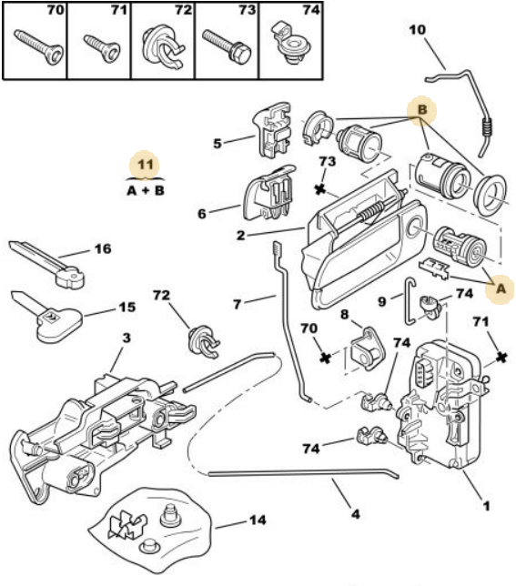

Part is 9170AY: Cylinder Block (random combination)
Price at Citroen here in the UK is £149.81 inc. our VAT @ 20%
or part 9170AZ - £69.92 for the combination specified on order!

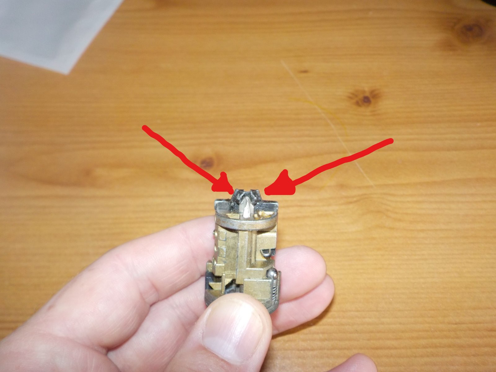

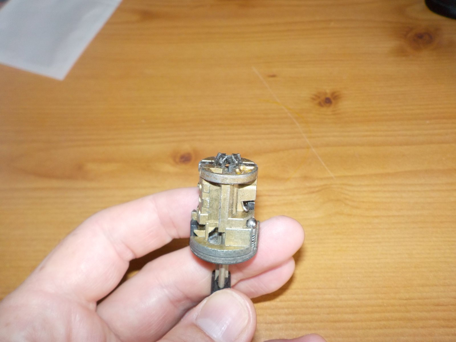

You can normally strip them down & sort them for this fault.
The first pic shows the inner part of the barrel before the key is fully inserted & the second pic is with the key fully inserted, what normally happens to the lock is the tip of the key should engage with the little black bits with the arrows pointing to them, they splay out over time so when the key is inserted it doesn't push the little black bar out of the mechanism, this black bar engages with the rear part of the lock & allows it to turn. All you have to do when you take this bit out is give the little bits with the arrows a little squeeze in with a pair of pliers, when you re insert the key just make sure the little black bar pops out the back of the lock. Give it all a good clean out & re grease on reassembly. That should do the trick.
This particular lock has already had a little squeeze if you look closely.
