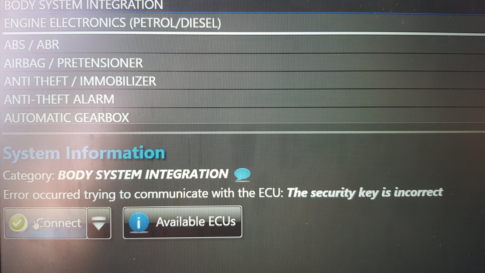

Hey all,
I'm trying to use the supescan, through Bluetooth adapter but get security key error.
How do I get the code for my 2006 C5 petrol 2000 to be able to configure stuff?

We recommend you use Diagbox or Lexia. There are no security codes needed for scanning PSA cars. I suggest you contact the vendor of the kit you are using - it's not a car issue. It is likely your kit is not able to worl with full CAN vehicles and probably doesn't recognise all the ECUs.
