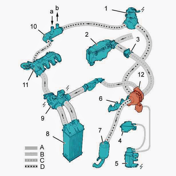

Here are the components of the air supply for your engine (DV6TED4) 110 with PEF.
ReferenceDesignation
aCoolant Inlet
bCoolant Outlet
(1)Exhaust Gas Recycling (EGR) Regulation Electrovalve
(2)Air Cleaner
(3)Air Flow Meter - Air Temperature Sensor
(4)Vacuum Reservoir
(5)Turbocharging Pressure Regulation Solenoid Valve
(6)Exhaust Gas Manifold
(7)Catalytic Converter - Particle Filter (FAP)
(8)Air/Air Heat Exchanger
(9)Butterfly Double Air Metering Device
(10)Exhaust Gas Recycling (EGR) Heat Exchanger
(11)Air Inlet Manifold
(12)Turbocharger
It could be that the turbo solenoid electrovalve (item 5) is not creating sufficient vacuum. These have a cap on the end with a filter inside that can become blocked, restricting the vacuum. You can try taking it off and cleaning the filter.

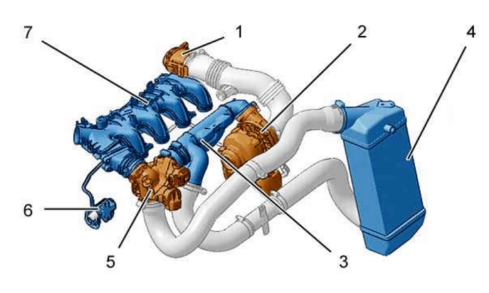

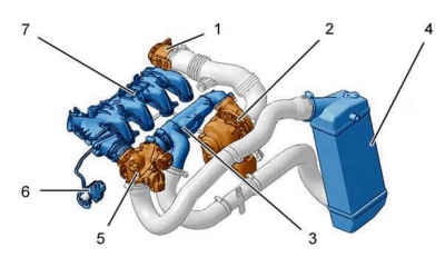

x 6945
Re: 407 Cruise Control Fault?
It's at the back of the engine - item (6):
