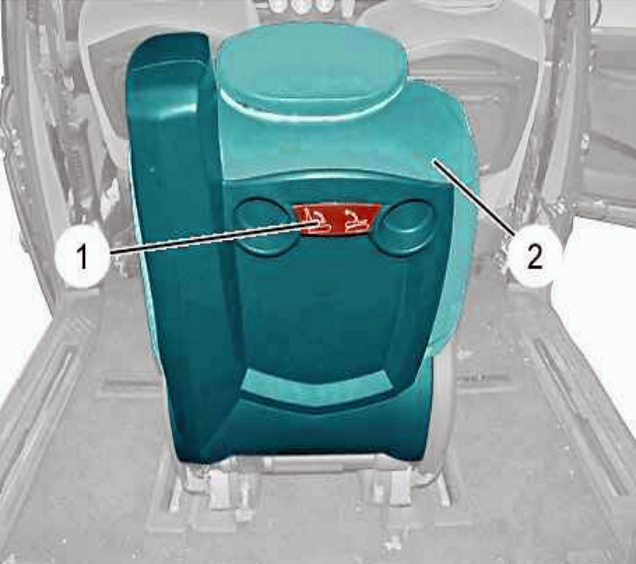

Pivot the rear seat backrest (2) towards the
front using the tilt control (1).

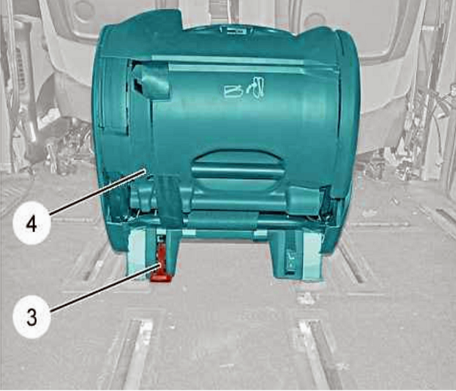

Tilt the rear seat (4) towards the front,
using the tilt control (3).

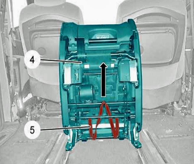

Pull on the strap (5) to unlock the rear seat (4)
(In the direction of the arrow ).
Remove the rear seat (4).

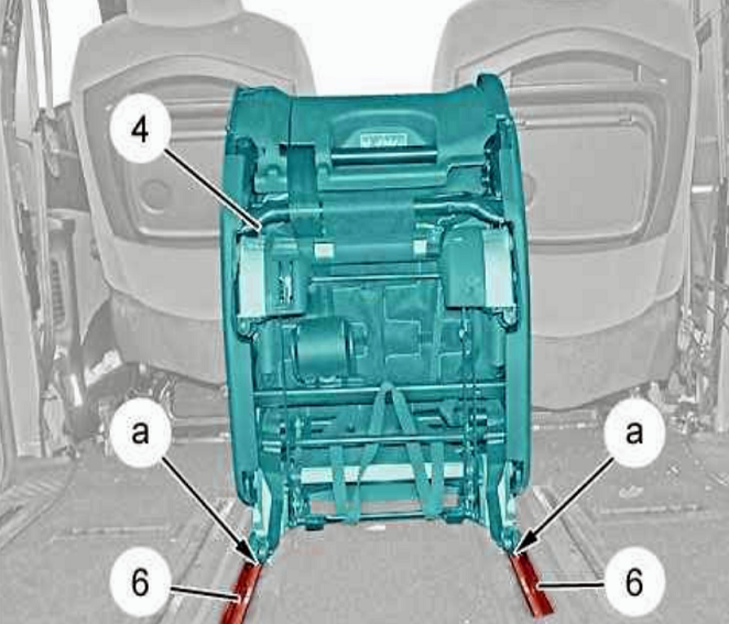

Refitting
  • Engage the rear seat (4) in the slides (6) (at "a").
  • Proceed in the reverse order to removal.
  • Check the operation of the equipment.
