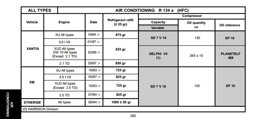

Re: Xantia - AC Refrigerant volume
From the Xantia Citroen mechanics' handbook.
Gives both gas and oil quantities...
? Click to enlarge A really useful booklet, full of repair/maintenance data. Download the complete booklet here:
viewtopic.php?f=3&t=61218&p=590278#p590278
Go for Xantia S2 in the table, and hit "2001".
