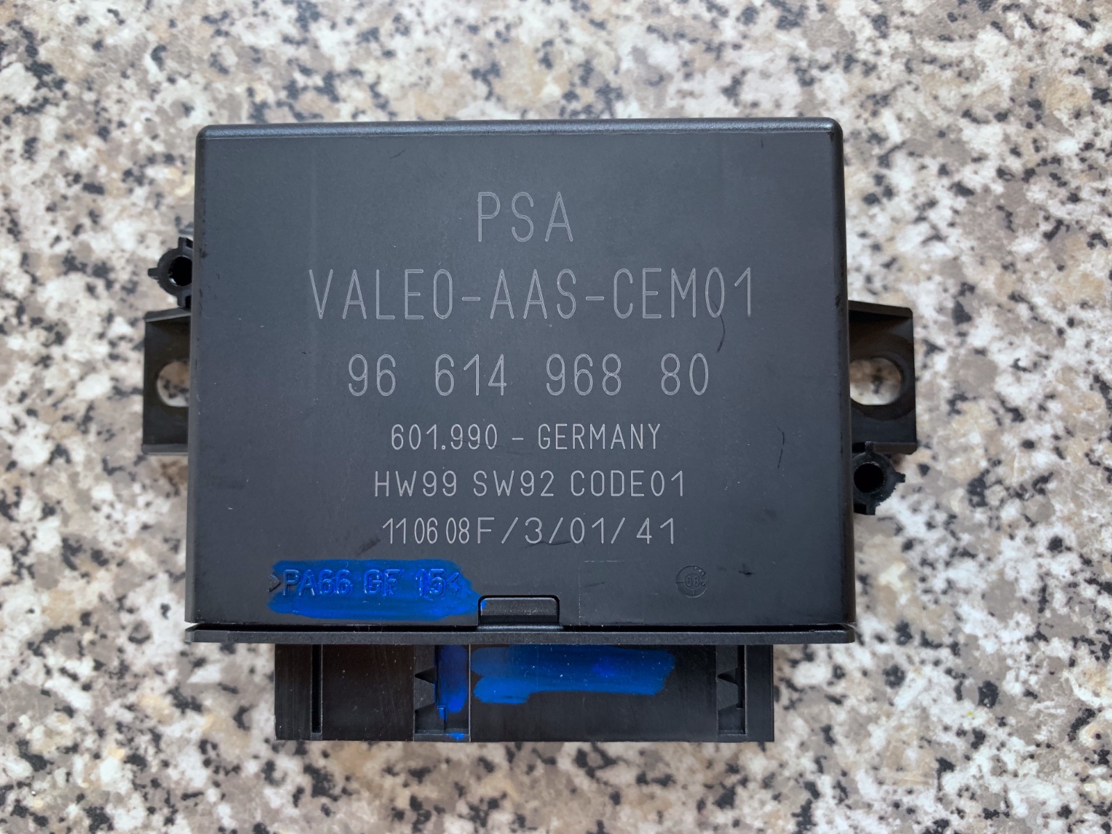

So I located a second hand module unit on eBay for £18 with exactly the same codes/numbers and purchased it.

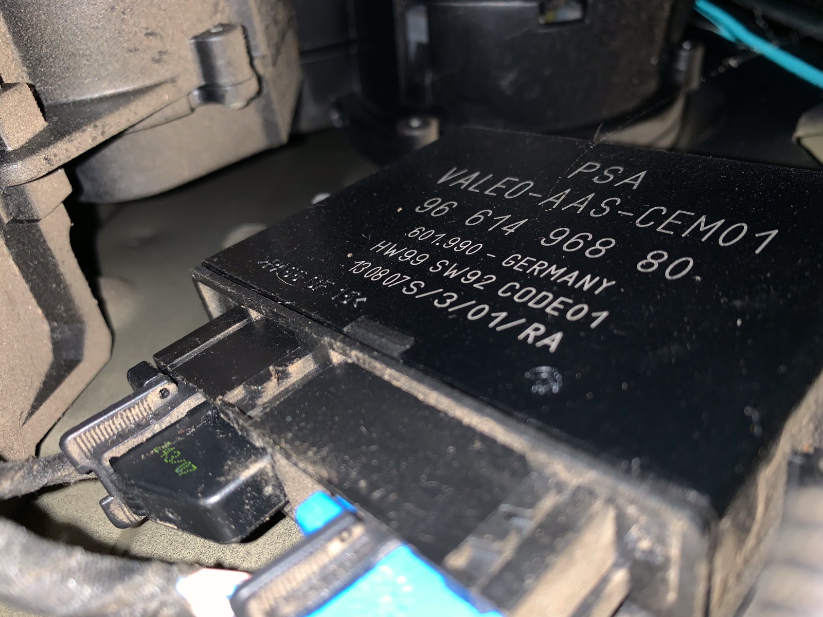

It arrived this morning and I quickly swapped the cables around from the car's module to the new one and proceeded to engage into reverse, full of hope. Nothing. As if its not even there.
Does anyone know if these modules need to be programmed for the vehicle specifically? I purchased the module as a fully working part, apparently from a Peugeot 207.
