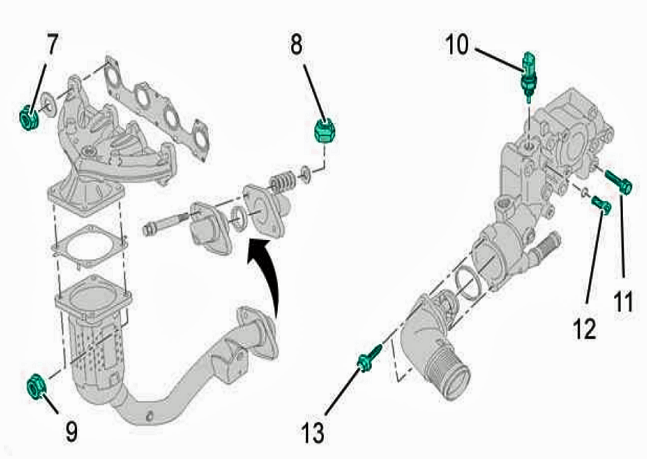

Hi, replacing this on a 2003 1.4 petrol 206.
x 6963
Re: Water temperature sensor torque value?
If it's number 10 on the diagram (Engine coolant temperature sensor on coolant outlet housing), then tightening is to 1.7 ± 0.1 daN.m
