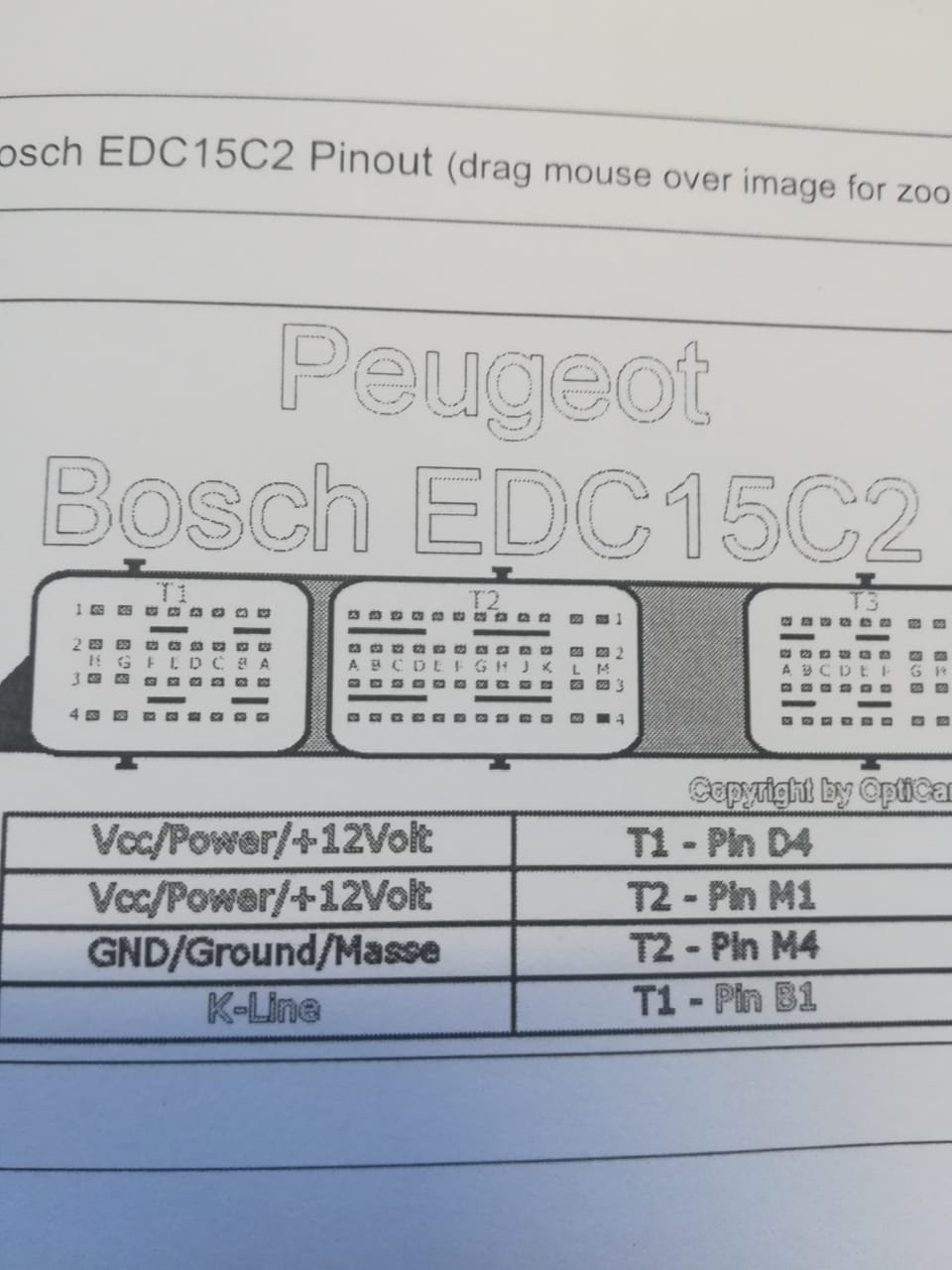

I have a 2007 207 1.4 8 valve. I have noticed that 4 pins in my ECU seems to be burned or something and I would like to know what they are for. I have searched everywhere but I don't seem to be able to find a layout of what pin is for what on the ECU. I did find a picture that mark these pins as plug T2 pins L1 L2 M1 and M2. Don't know if that helps. Its the centre plug on the ECU, top two rows, last for pins on the right hand side.

Ok, so ignore that diagram you had - that is for a Bosch system. You don't have that injection system - you have a Johnson Control unit.
