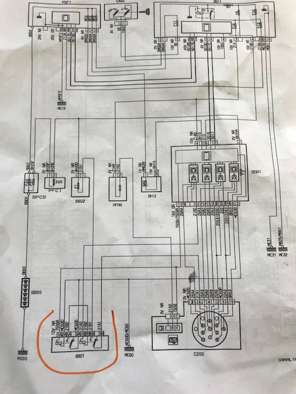

I'm looking for the location this relay 8801
My car is a 2009 C5 X7 tourer 240 HDI
Citroen C5 Tourer 3.0 V6 HDI 240 2009
x 6946
Re: Relay 8801 in C5 X7
That's the Trailer Double Relay - probably part of the optional BSR unit you can buy for plugging the towing electrics loom into - which connects to the vehicles electrical systems.

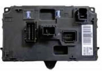

This is the BSR trailer unit: It is purchased separately.
