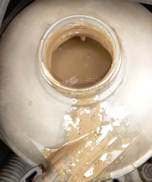

So a couple of possibilities...
Does it look anything like this?
This is what will happen if a lot of oil starts to get into the expansion tank - it looks like mayonnaise.
Now unless I'm mistaken the 308 106 HDi has an air cooled oil cooler. The engine coolant variant uses the engine coolant system to cool the oil - and this is where a failure can result in oil getting back into the coolant system. Post your VIN up so we know what variant you have.
So if you have an air cooled oil cooler, that rules that possibility out.
That leaves a crack in the cylinder block or a misaligned head gasket as there aren't really any other places for oil to get into the coolant system.
Until you find out for sure, be VERY mindful of the engine temperature - but not recommended to drive it if possible as the more you do, the more damage will be done. Obviously when you find the problem, you'll need to fully drain and flush the radiator and the cooling system thoroughly.

The oil still looks like oil if that makes sense - not mayonnaise.
We have changed the oil cooler, problem still remains.
How likely is a cracked block? This is a 2011 car with about 50,000 miles.
Not being driven at the moment, as the head is off
Thanks
Thanks
