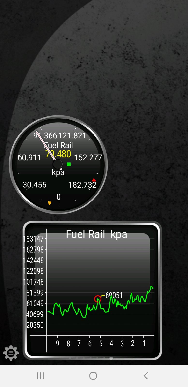

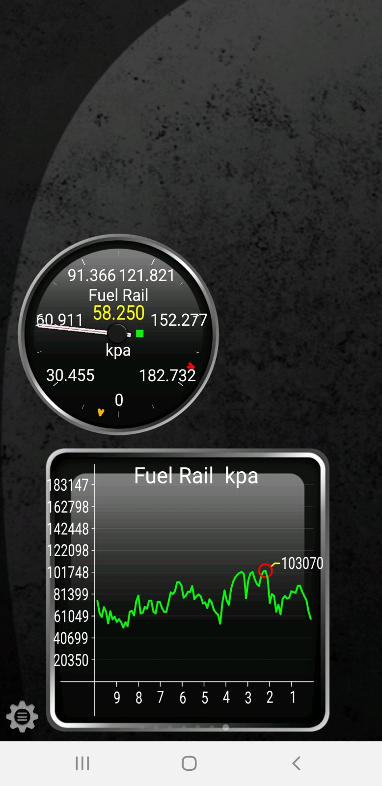

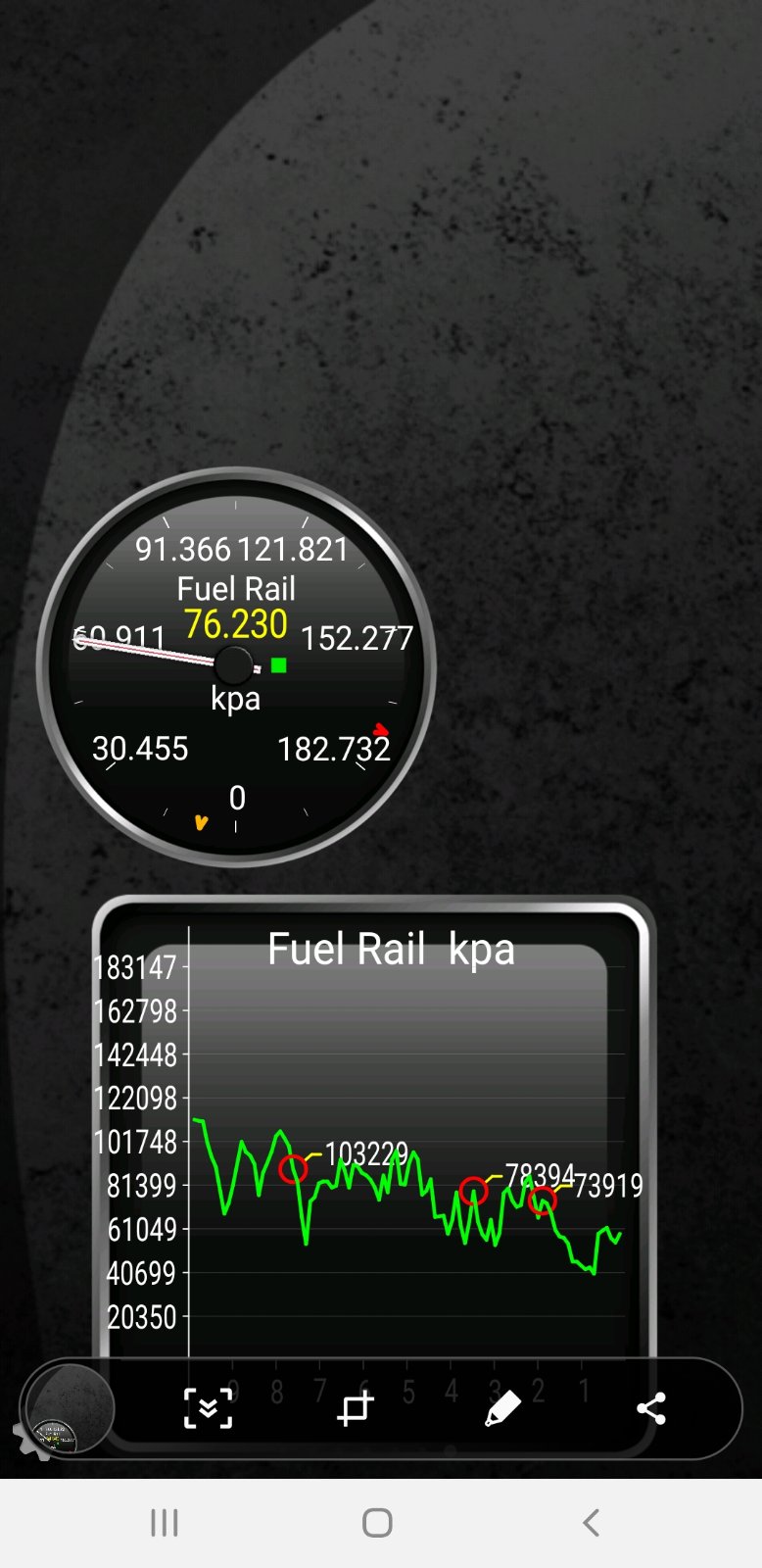

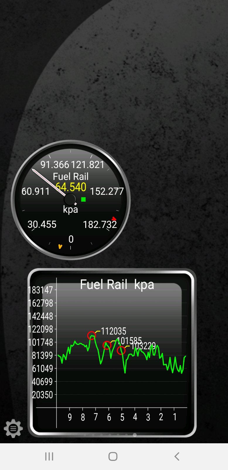

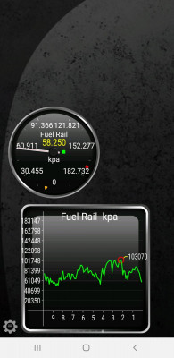

Hello!
My Peugeot 308 (2008.) 1.6 HDi for already a month is stalling at a set rpm, the car is bumping until i come to a stop where it usualy cuts out or barely survives on like 400 rpm.
I would also like to mention that it sometimes is very hard to start him up because it stalls heavily on idle rpm, it stalls to a point of shutdown.
Before it had an error code P1166 but that code disapeared before I came to a mechanic, and now because of that mecanics dont want to inspect my car because it has no error codes.
Here are the pictures od fuel rail pressure while driving at set rpm of 2000.
Please help in any way I am lost!
Thank you in advance!
