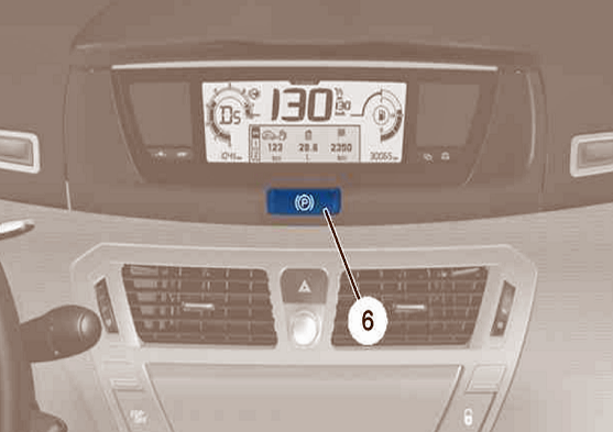

The system uses Dynamic Emergency Braking. It is handled and controlled by the ESP ECU.
In an emergency, (say the driver becoming incapacitated for example), the passenger should pull the electronic handbrake lever fully and hold it continually. The ESP detects this and will bring the car to a controlled emergency stop using the stability programme.

In your case with your C4 Picasso you pull it - which is what you would normally do to apply it, or press to release:
