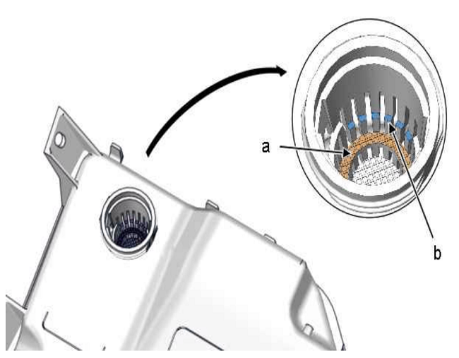

No you don’t need to depressurise to check the fluid.
See my post here and look at the diagram for the tank filler neck. It shows the levels it should be on the lowest suspension setting. Just allow enough time for the car to sink.

They should of topped up the fluid (never re-use old reclaimed LDS) and properly bled and refilled according to recommendations.
Get some more LDS and ensure the car is always checked on the lowest setting and then switch the engine off, then slowly add some fluid until it is in between the 'a' & 'b' marks below.
To bleed, ensure the system is on the lowest height setting, then with engine running, very slowly turn the steering wheel lock to lock 10 times. Slowly! Then centre it, stop the engine and top up the LDS if necessary to the marks.
