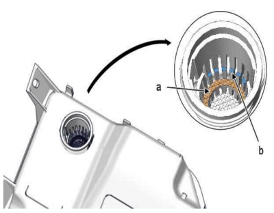

Could be - but important to check the LDS level after a while. Another member just had his rack replaced and he had to put in at least 2 litres of LDS after the steering and suspension went tight / hard.
Check the LDS level on the Lowest suspension setting with the engine off.
Level should be between A and B mark. But do check after you've driven it for some miles.
