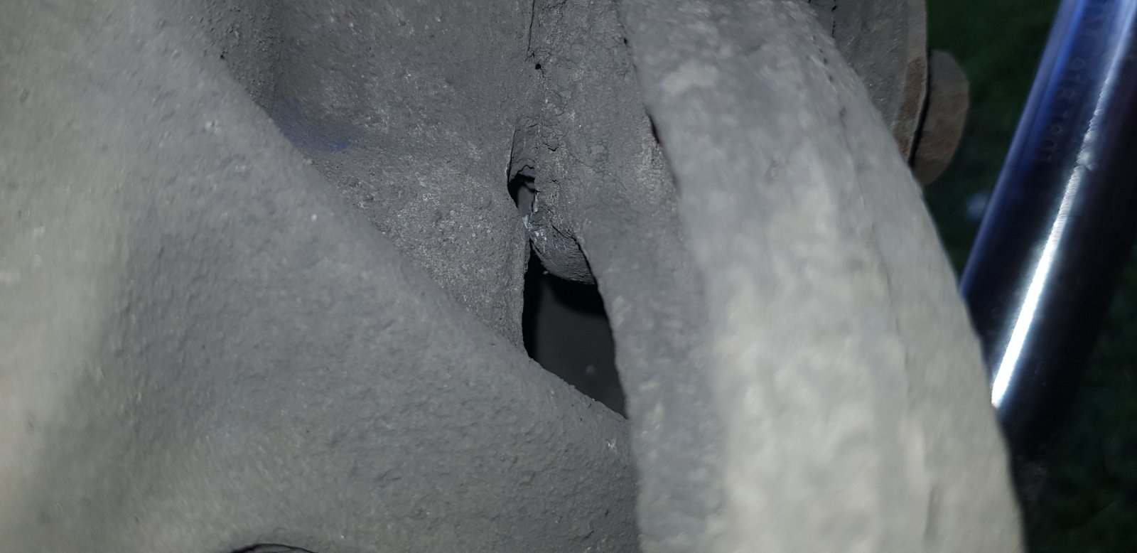

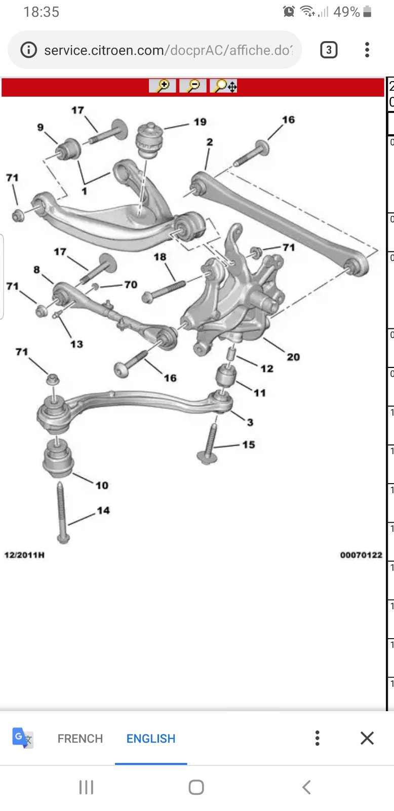

Hi, Has anyone any tips or advice for replacing item 3 (longitudinal link I think) Is it best to replace as a whole or just the bushes?

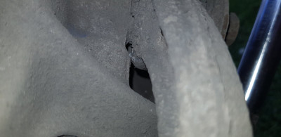

On mine bush 11 has failed and item 3 contacts the hub carrier item 20 causing a knock. You can just see the point of contact in the photo.
Will the nut (71) be inside the car?
Many thanks

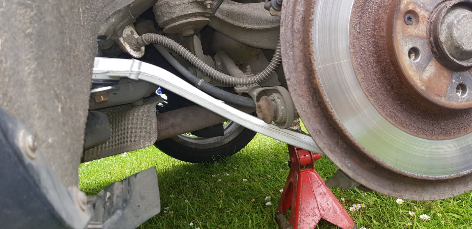

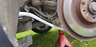

Job Done.. 30 mins total... Nut 71 is captive so no issues :-)
New link
New link

Well done.
Posts: 9432
Joined: 07 May 2009, 16:24
x 1943
Re: Rear suspention longitudinal link!!
Unread post by Paul-R »
Yes, good job there. Rear disc looks as though they could do with replacing before too long though.
