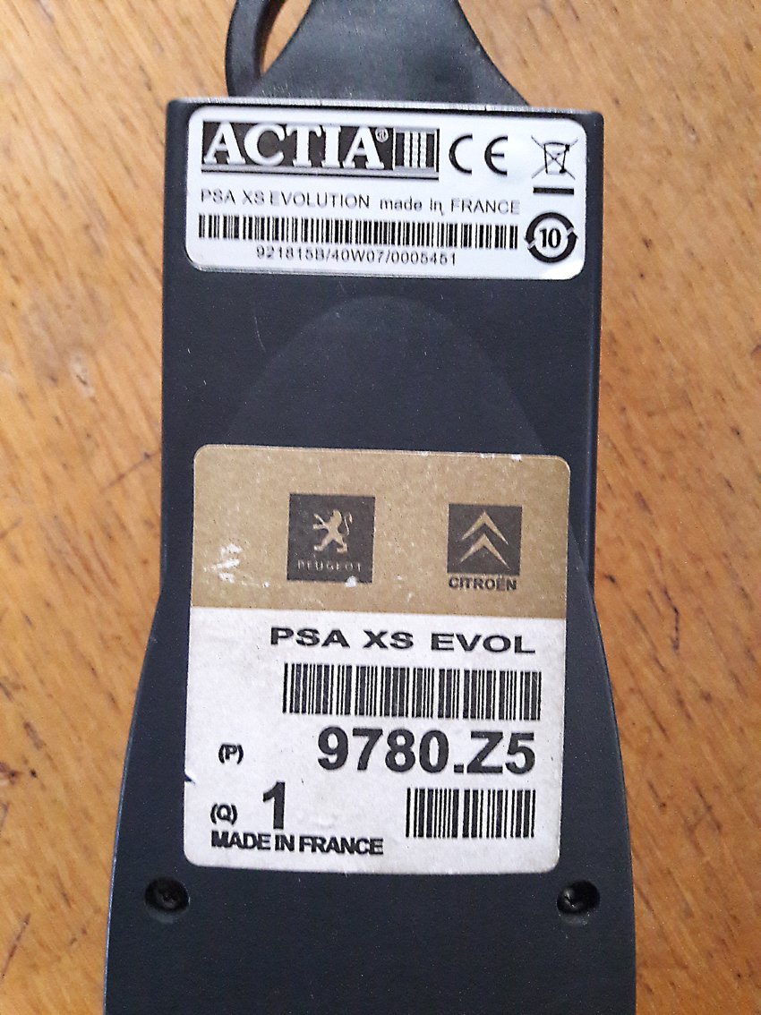

Just checked outside of case. There is a B/ at end of first part of serial number. And I have had it at least 5 years, maybe 6. Maybe, like me, it's just too damn old to keep up with the younguns.

There is, somewhere (I think Marc has it) a program that can tell you what revision chipset your module has got. Mine is a rev. B chipset, but somehow (for reasons unknown) it is prepared to work with DiagBox 7.15. I disable the WiFi on my netbook before I fire up the DiagBox software, and I do not let DiagBox check for updates (it wouldn't succeed anyway, as it would not find a connection to the Internet). I think that, as the physical network port is not disabled (despite it not being physically connected to a network) the DiagBox software is prepared to work.

ignore the serial number, most of them have that, when they cloned thes, they also cloned the bar codes and the labels!petef wrote: 27 May 2019, 21:36 Just checked outside of case. There is a B/ at end of first part of serial number. And I have had it at least 5 years, maybe 6. Maybe, like me, it's just too damn old to keep up with the younguns.
The only way to ascertain the version for sure is to open her up and check the boards. It’s quite easy to do.
