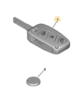

The key from Peugeot will cost you £104.98.
The part number is: 1626717680

If you are getting a new fob and key cut you’ll have to code it to the vehicle. If you are going to transplant the key with transponder into the new fob case you will be able to start the car, but the remote features may not work until it is paired. If you are transplanting the key and circuitry, you may as well just get a blank shell for a few quid. Depends what you want to do.
