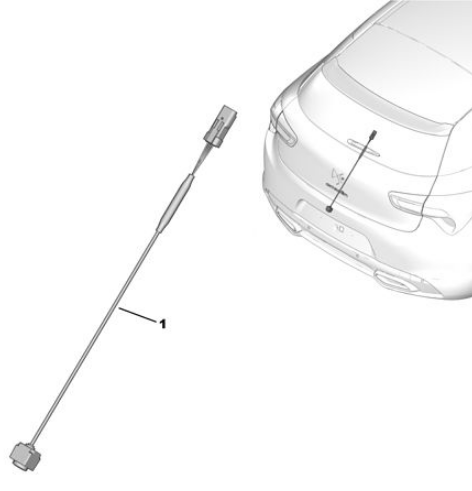

Re: DS5 Reverse Camera
The rear bumper has to come off to get to the wiring as it's built into the bumper not the tailgate. Also the rear undershield deflectors to get to the securing bolts of the bumper.
Yes. The camera harness first has to be unclipped from inside the bumper where it is secured, (note these are very tight cable tie clips, so have to be cut and replaced with new ones) and the electrical connector to the harness is near the far left inside of the rear bumper (standing facing the rear bumper). Then the other end (camera part) is secured with a bolt that has to be undone and 3 plastic retaining clips that need pushing in together before the camera and the small harness is fed out towards the outside.Smartest_Smarty wrote: 26 Sep 2020, 12:05 Is the camera secured to the rear bumper? As I can’t really see or feel any thing holding it there. Does it just pop out?
Hence why the bumper needs to come off.
