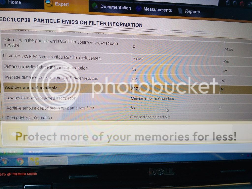

Hi all,
I needed to replace the additive pouch on my 2.2 hdi 4007 .
Managed to reset the counter and to ,,bleed off" the pipes using diagbox .
After starting the engine there was a short interval when I heard the eolys pump working.
The level was set to 3273 ml. available.
Since then i used the remaining fuel an went for the gas station to fill up ~ 50l. of fuel hoping to hear a short run of the additive pump ...but no!
Connect to diagbox and the quantity was still the same 3273ml.
Ok...maybe during first bleed of system puts some more of the nasty cerine so i used all fuel again .The car do successful regeneration and all seems fine.
Fill half tank but still no reduce of quantity available.
The magnets of the fuel cap are present.
I have done a test of the pump and it is working.
I am afraid to run the car knowing that the system is not threating the fuel.
No warnings recorded so far.
Maybe something done wrong with the diagbox???
Thanks :)

Yes yes - in fact, but theoretically at system level on each fill up the ecu should reduce the total quantity left.
I am confused that the value is not changing.

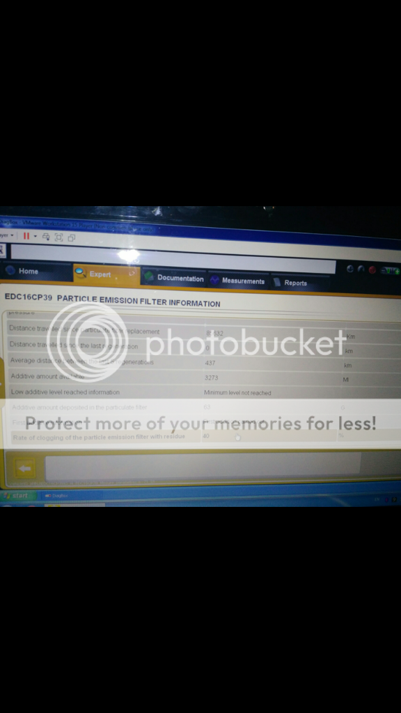

This is the q/ty that should be used 2.4ml per 1000km - something like 80 litres.
This is ~ 2 tanks of diesel.
I was expecting after each fill up to see this number decreasing(on picture above).
Untill replacement everything seems correct .
