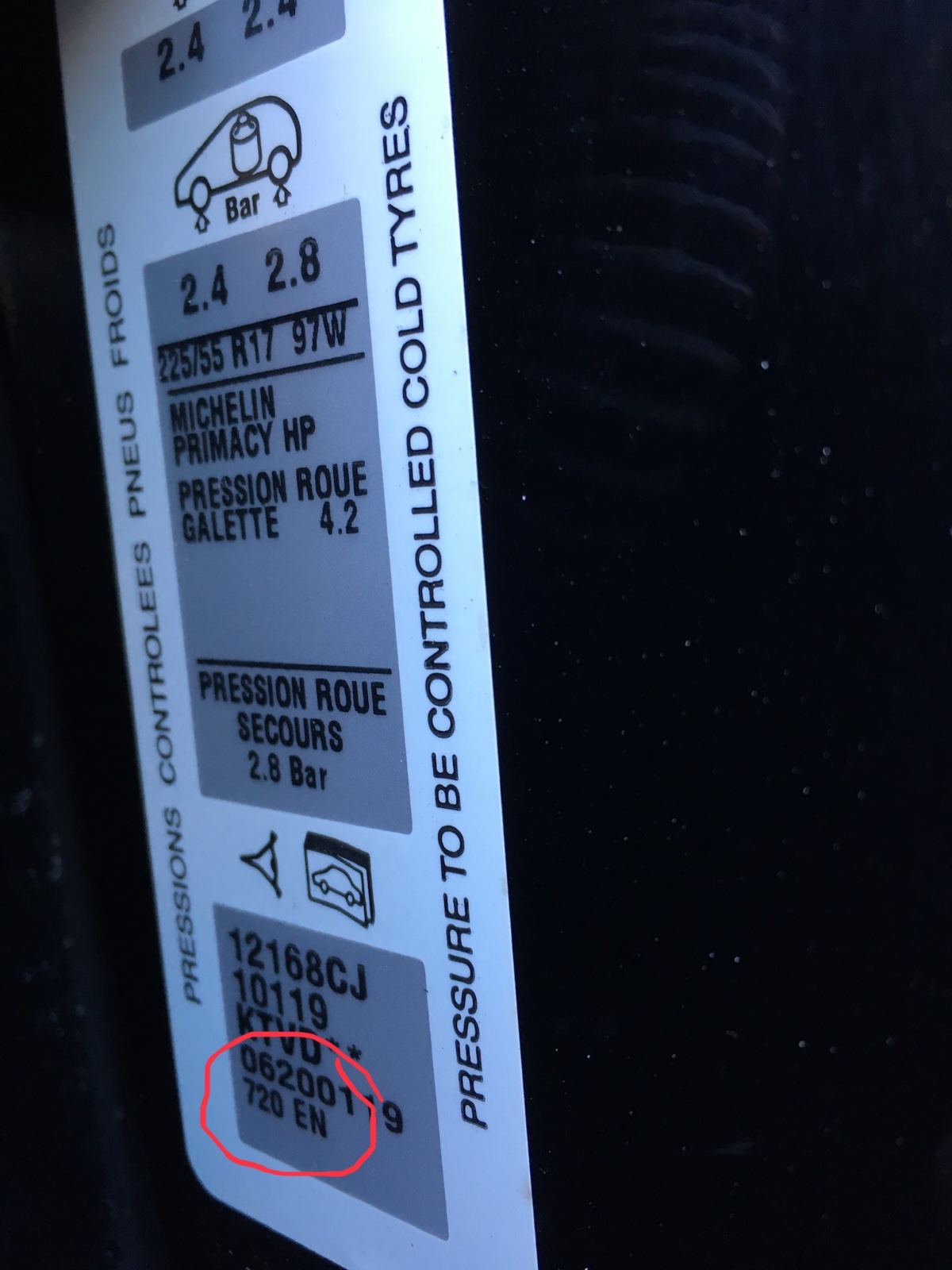

As it has stop/start it will almost certainly have an AGM battery fitted or an EFB at the very minimum.
Most modern PSA cars now have the original battery spec on the tyre pressure label & it will say if its AGM or not

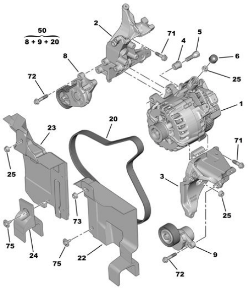

Ok, so be aware that you need a Reversible Alternator as you have Stop Start system.
Part Number: 5705PA. These will be either a Valeo 180 AMP IST60C028 or IST60C017. You can check which from the old one.
Your battery is an AGM type and a 70AH 760A

well, don't I feel silly. Just got a call from Peugeot saying the SAME thing! :oops:
Turns out the belt is slipping which is causing all the problems (apparently.) He also advised to replace the lower belt pulley (or something or other) but says the alternator is perfectly fine.
