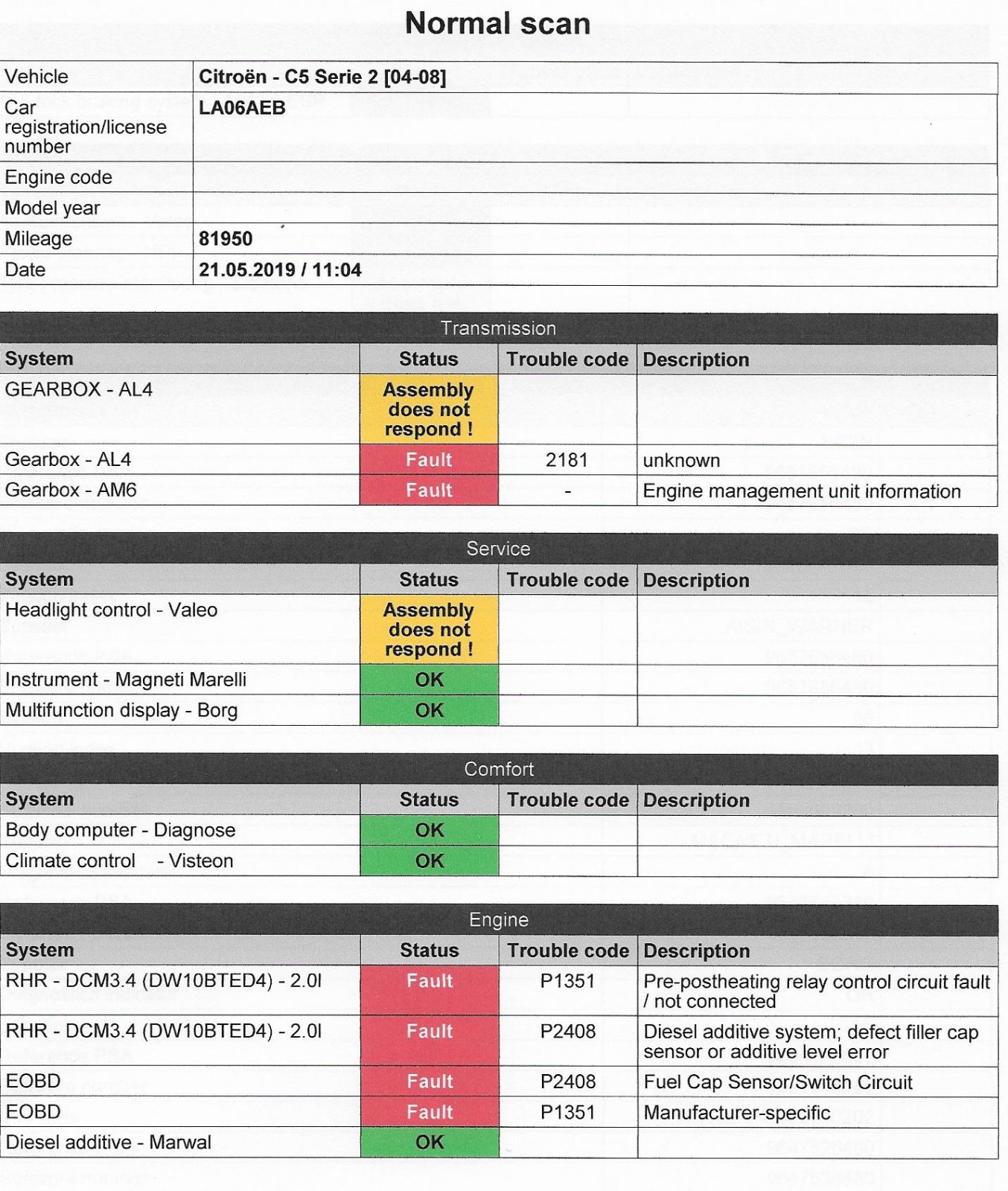

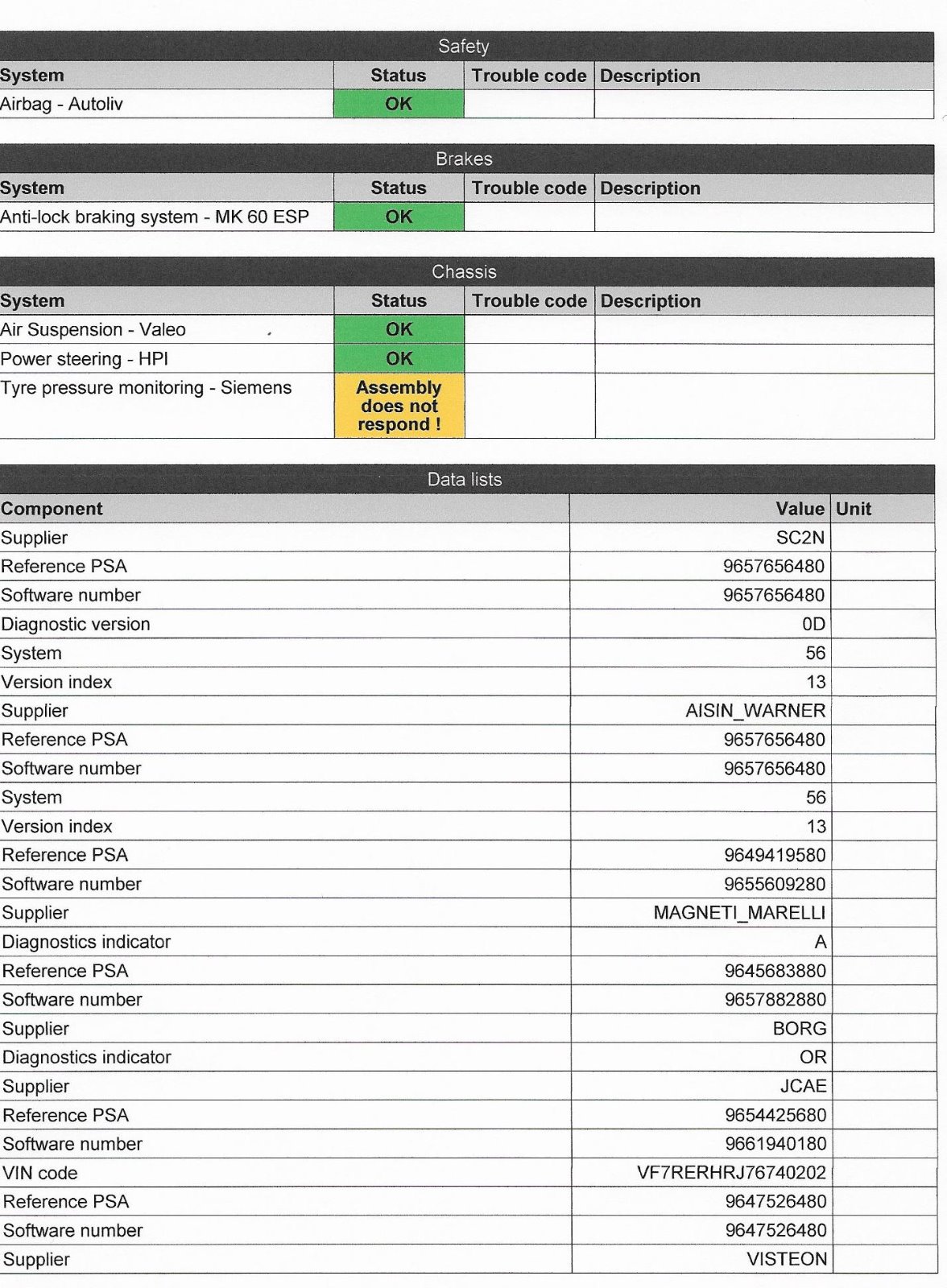

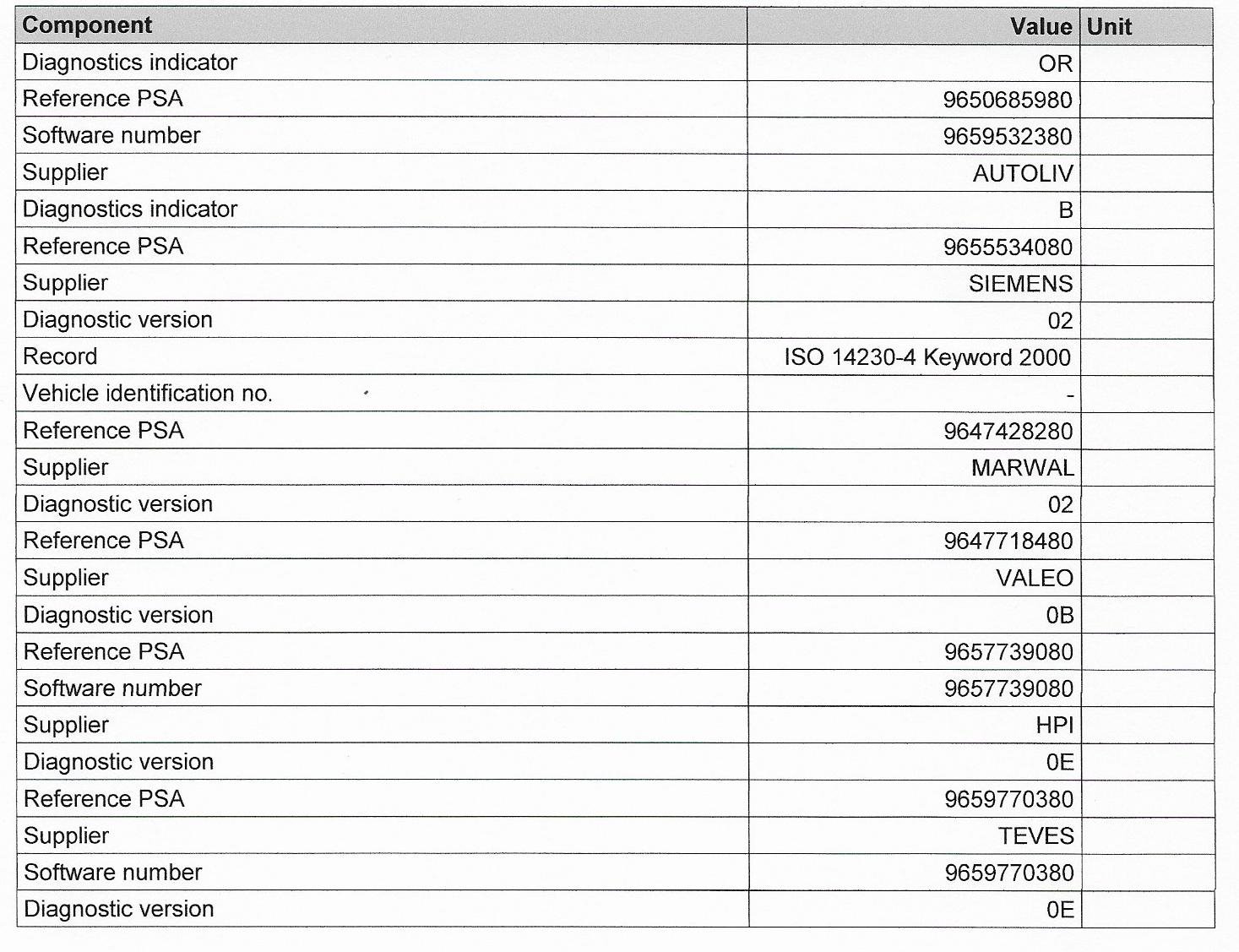

Finally got round to running the scam again this morning this is the result
Sorry you'll need to look at them from the bottom up.
