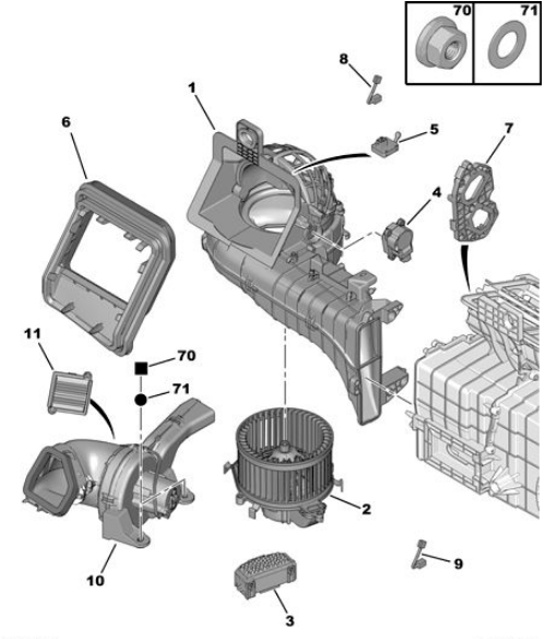

This model has he single Air Conditioning System. I suspect your blower control module may be on the way out. This one I believe is attached directly to the blower motor, although is available as a separate part.
Your blower control module is item 3 below - you don't have item 11 on your model.
What tests have you done though?
If you direct all air distribution towards the middle (fascia front and side vents) and start off at the lowest blower setting and then slowly increase a step at a time what happens from lowest to full speed? Are you getting minimal speed or max and nothing in between?

Re: Heat blowers
Ok, that's not a really good test, when driving because you are getting the 'ram' effect of air being driven into the vehicle whilst it is in motion.
So if you are not getting anything at all when stationary, then it is likely to be your control module.
The part number is 6441CE. £223.15 inc. VAT from Citroen.
You can get a decent quality one from VEMO (German Made):
https://www.euspares.co.uk/parts/vemo/12250339 for £116 inc. VAT

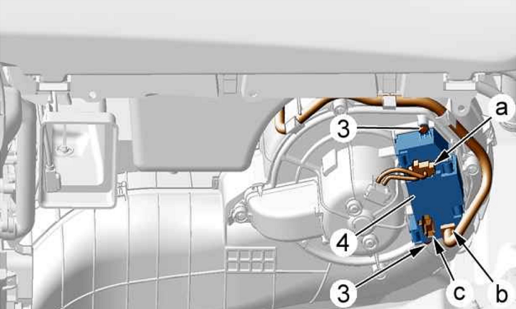

It's the item in blue shown here: There are cheaper ones from £30+ but there have been many complaints about the real cheap ones simply not working or dead on arrival. - up to you, but the unit is accessed from the driver's side footwell - above the top trim.
I can provide some guide for getting to it if you are going to attempt it your self.
