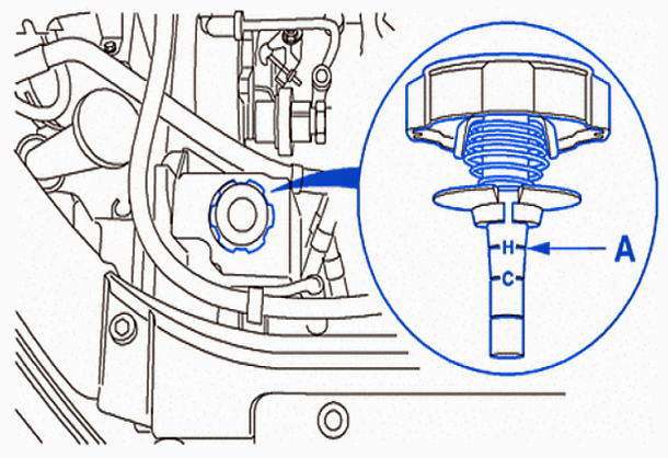

Fill the power steering reservoir 10 to mm above the maximum mark (A).

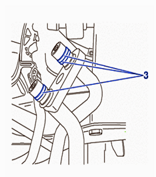

| Refit the new seals ( 3). | Refit:
| (H): Maximum level (Hot) . (C): Maximum level (Cold) . |

Again fill the reservoir up to the maximum level (A).

- (A) Maximum level.
- The level must be set with the engine stopped and the wheels straight ahead.

2) I got the seals for both ends on the supply and return pipes in case it makes sense to completely disconnect these to properly drain & flush the system. Would you recommend the extra effort?

2) Always change the seals if any of the pipes are coming off - reason being is that once disturbed / removed they will never 'mate' again and this will ultimately create a leak in future and you don't want to be doing that again.
