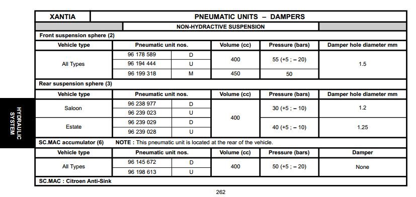

This is the full spec for the non-HA Xantia spheres...
Click to enlarge Ignore the part numbers, which have changed.
If using non-genuine Citroen spheres, make sure the Damper hole diameter is correct, because this will directly affect how the car damps out sudden surface changes. Some aftermarket suppliers don't seem to list it, which isn't helpful.
Hope useful.
