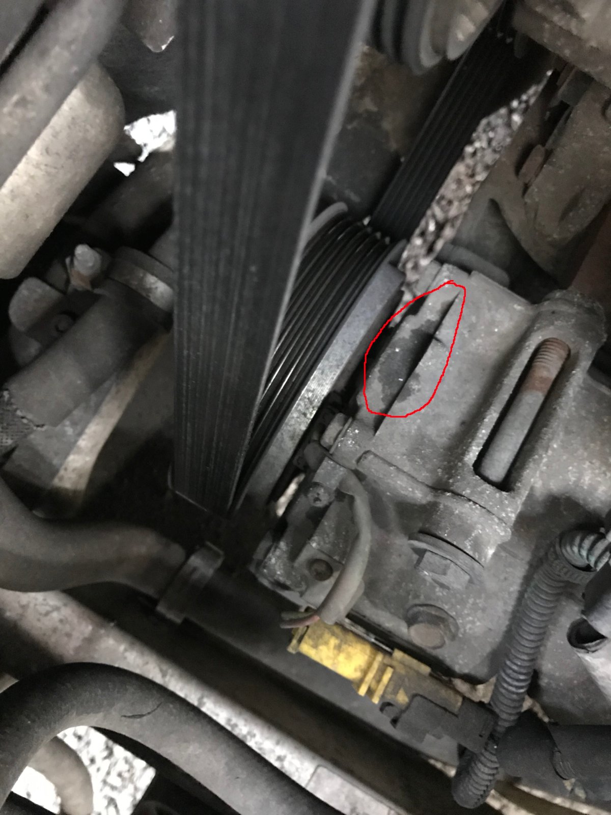

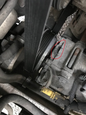

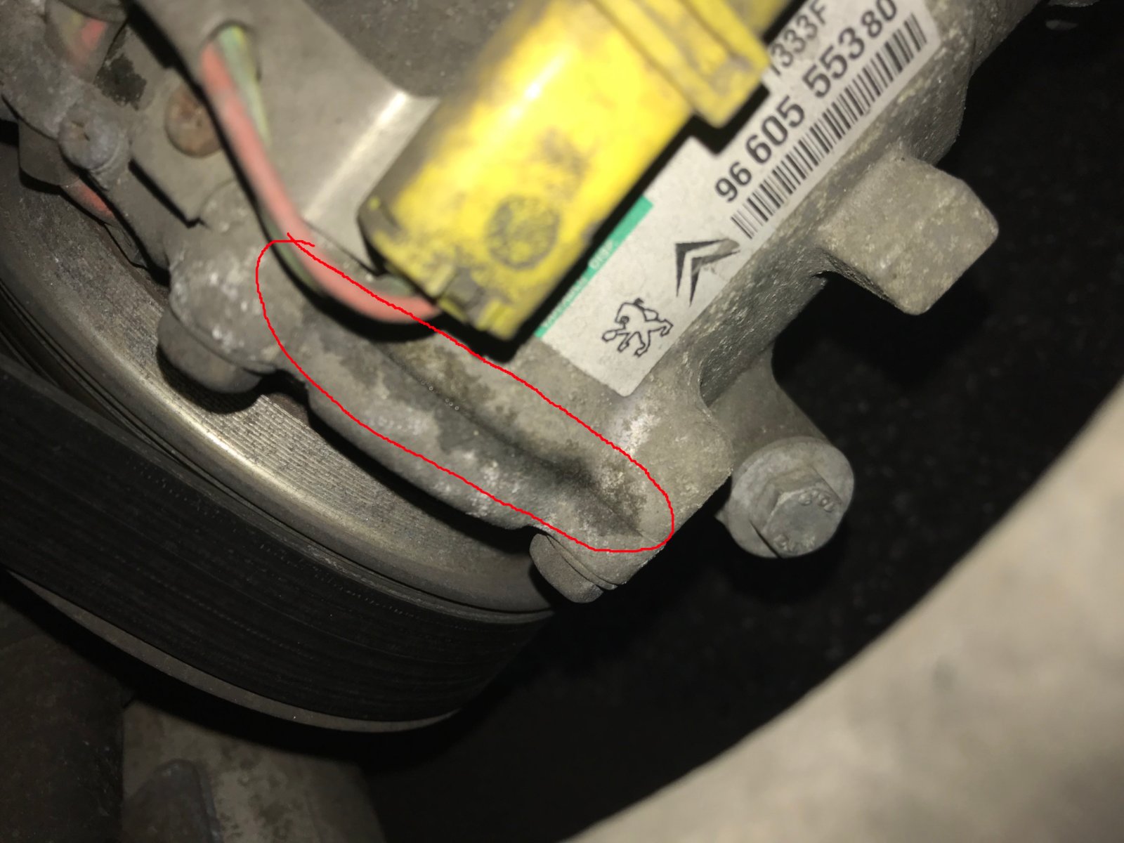

Since a refrigerant recharge last summer my air con had all but lost all effectiveness and the system hissed loudly inside the cabin, the usual sign of low refrigerant charge.
When I checked the pressures, I found the low side pulling down to 0 psi and the high side was really low for a 134a system.
The system was recharged once again and this time I included 10ml of fluorescent PAG oil.
My plan is to wait for a few weeks then cast a UV torch about to try and locate the leak. Whilst i am waiting for the torch to arrive I noticed some suspect patches on the compressor itself, right at the part where two parts of the compressor housing meet:
Time will tell if this is the source of the leak when the UV torch arrives but I thought I would ask if anyone would find these patches suspicious first.

I did the recharge myself. I have a vacuum pump, but didn’t want to empty it all out whilst it still worked (at least a little bit).
I added some refrigerant, but that was mainly to push the dyed oil into the system.
I am fully expecting it to be the condenser, judging by the state of it; but after seeing those patches on the compressor I thought it would be worth querying as they do look suspicious.
