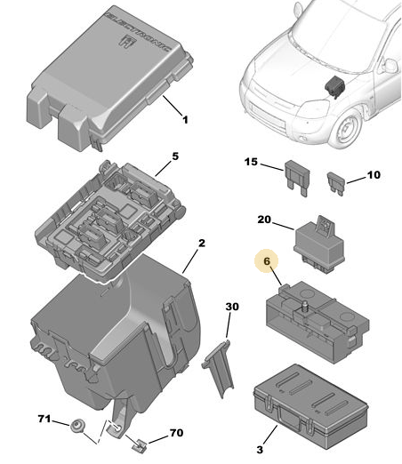

I want to start off with checking fuses and relays just to make sure it’s not them but I can’t for the life of me find anything on the internet pointing to where they are!
If someone could hp me by telling me where the location of these are, and also any pointers to what’s causing this if it isn’t the fuel pump.

Re: Peugeot Partner Fuel Pump 2003 1.9
So you have a
PARTNER VU (M59) SHORT VAN '600' 1.9 D 71 (DW8B) Manual gearbox 5
This is the location of the relays and the engine fusebox - the other relays will be near and around this area.
3 is a Relay Box
5 Is the Engine Fuse Box
6 is the Maxi Fuse Box
20 is Likely to be the Glow Plug Relay,
3 is a Relay Box
