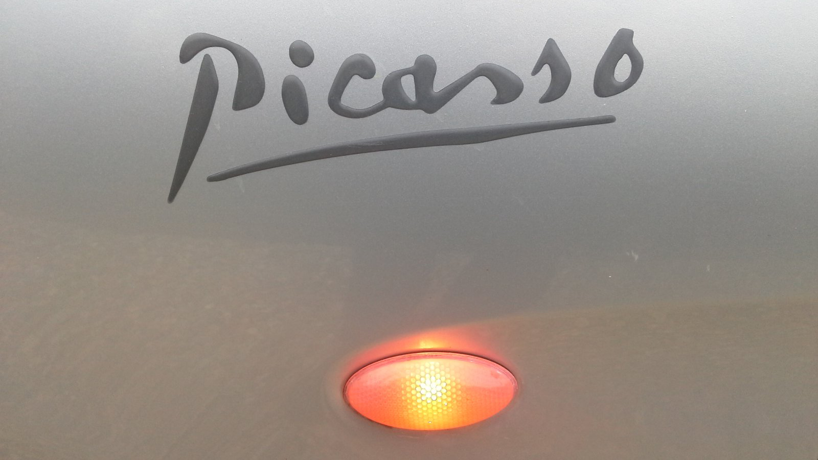

one thing he did mention was the repeater colour,needed to be a bit darker,So will be hunting in the Misses Nail Varnish's, ORANGE OR RED,??????.
Question is how to remove them without damage to cover or paintwork,??.
Ansers please guys,Thank You..

The repeaters in the wings use W5W/501 bulbs with the glass envelope covered in amber lacquer. In time this lacquer gradually flakes off making the light less amber. Sounds like yours just need the bulbs changing. I don't think that they're a suitable case for repair!

Hi Thank you for the reply,took the bull by the horns and prised them off with a flat thin screw driver,with cardboard protecting the bodywork..
painted the lense with orange nail varnish, couple of dabs of super glue and they look really nice.Pleased with the outcome, look brand new..

Glad it worked - but a little surprised that nail varnish didn't melt the lenses.
Paul-R is right about these arsenic-free bulbs needing replacing periodically - but "chrome" bulbs look so much better behind clear lenses (which you don't appear to have).

Well the lenses were CLEAR but bulbs had lost their colour,So painted the lenses instead.
MOT bloke prefered them to be coloured obviously,
Rather than change the bulbs,just painted the Clear lenses,job done,and look quite nice.
Used this trick many years ago on the REAR LIGHTS on the car for the RED.
Works a treat,instead of buying NEW Clusters.{Nail Varnish}.
