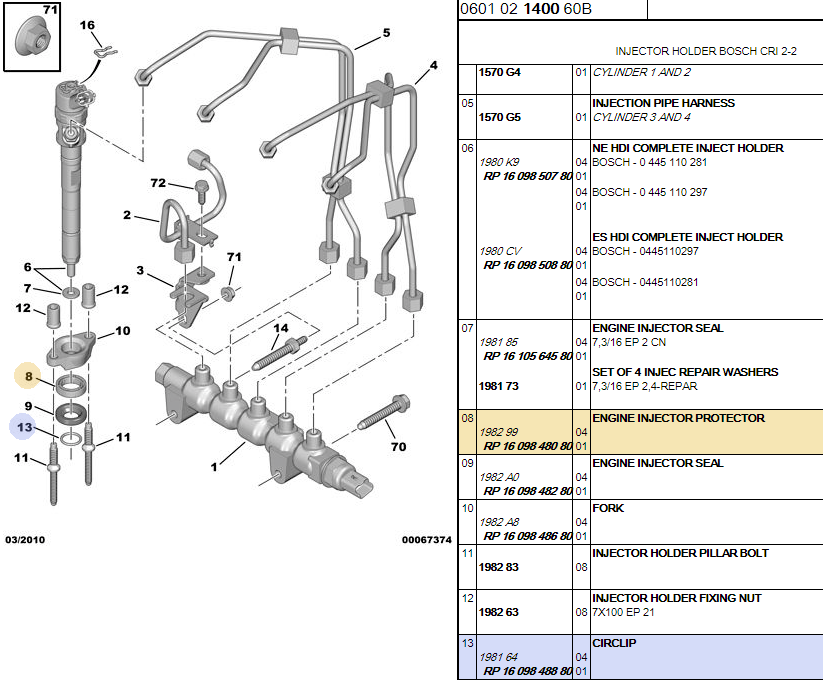

I've got an injector leaking, I'm wondering if some has the part numbers of seals required to repair.
I believe i need a copper seal and a seal for the top of the chamber also?

Yes you can order Citroen parts from Peugeot - they use the same part numbers and systems.
If you want genuine parts:
Part 7 is the top seal, part 1610564580 (£2.95 each) or a pack of 4 is part 198173 (£10.04)
Part 8 is the copper protector part 1609848080 (£4.60)
Part 9 is the seal, part 1609848280 (£5.77)
