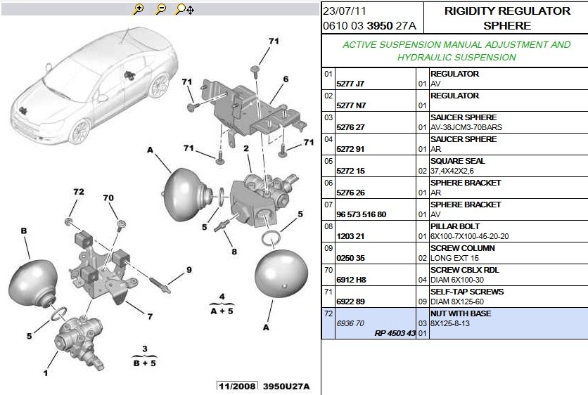

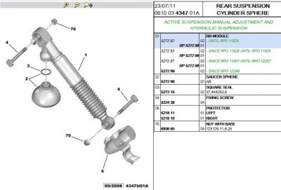

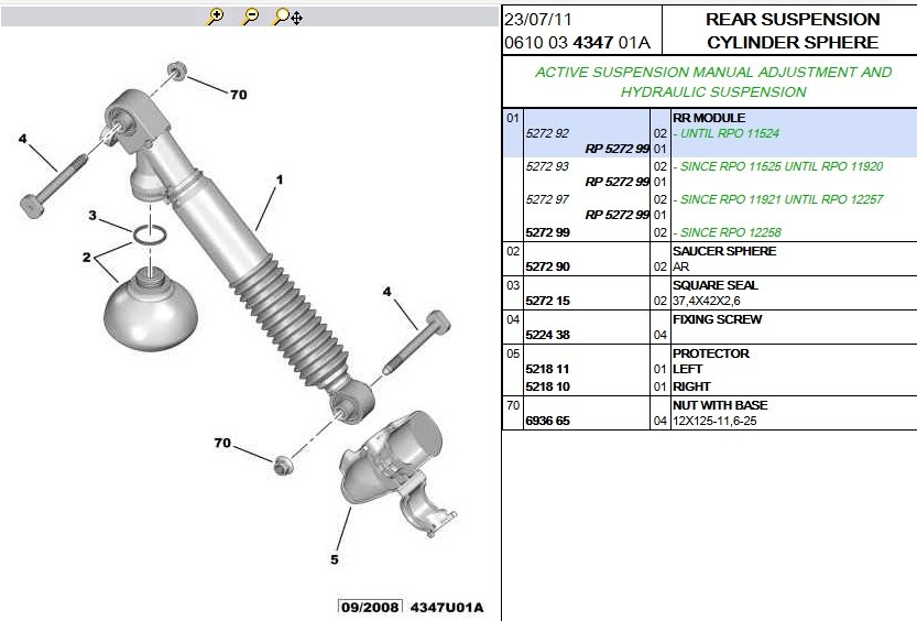

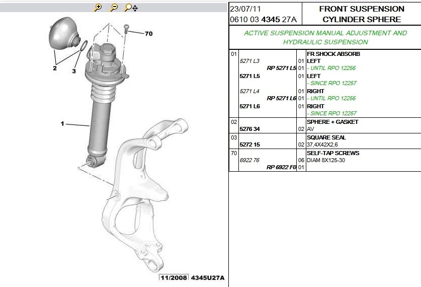

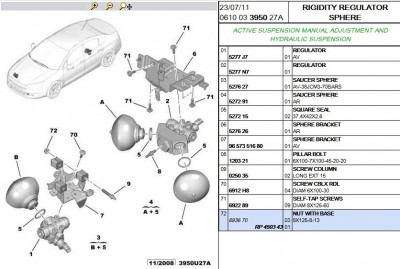

A generic look-up for a 163 Tourer* gives these:
Sphere1 - PSA, fair use
Sphere2 - PSA, fair use
Sphere3 - PSA, fair use
* - ignore the fact it shows a saloon in the diagram, these diagrams are for the Tourer. Part numbers may have been superseded since publication.
