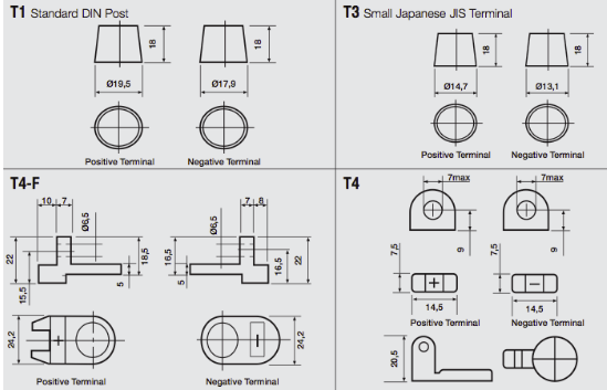

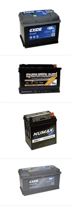

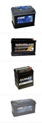

There are significant sizes differences depending on capacity and type, a few examples below:
As the space available and terminal cable lengths are important and in the case of the Xsara Picasso where the battery is under the front passenger seat, it is important to get one that fits.

Sorry Marc, we were at X-purposes: I though you were suggesting there were different size POSTS; obviously case sizes vary, according to capacity &, sometimes, application.

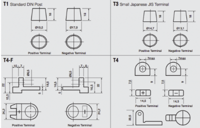

For the most part the batteries over here are pretty standard - but there are different types fitted to some Japanese cars and BMWs can have a slightly different size post - but not too significant as the post clamps should fit for most European cars - although there are terminal post adapters.
