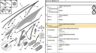

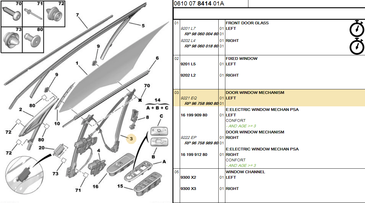

Here are the part numbers - PSA offer 2 versions - an OEM original one and a cheaper version. Note item 4 is not available separately. These are the part numbers for your X7 (I have your VIN from before).

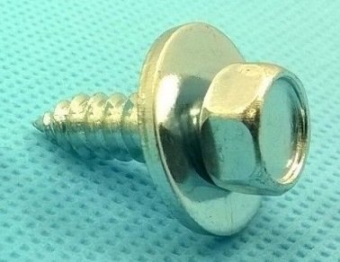

When I replaced my winder mechanism I didn't have rivets thick enough to hold the speaker but I had a box of tec roofing screws so I used those, removing the washer and taking a slice of the hex heads.

Had to replace mine last year. Took me a an hour or so. Had to drill through the rivets to remove them and then used similar screws as JohnD. You will have to grease generously all wires.
