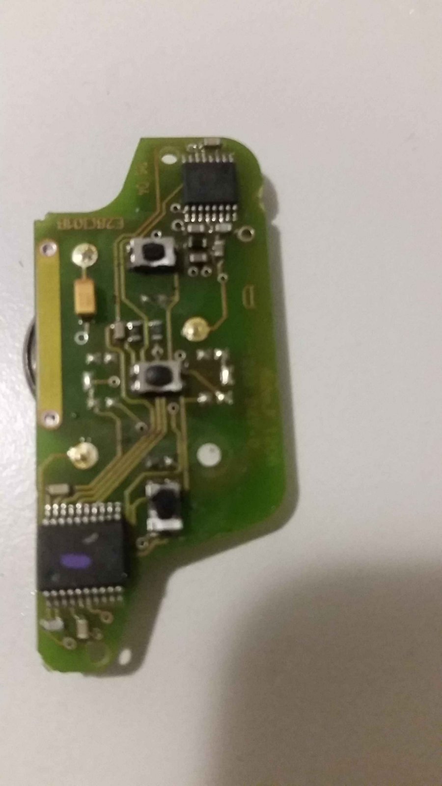

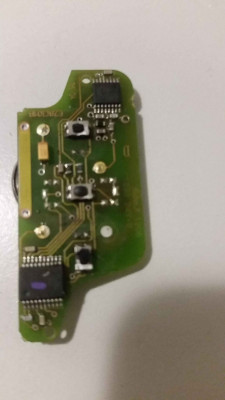

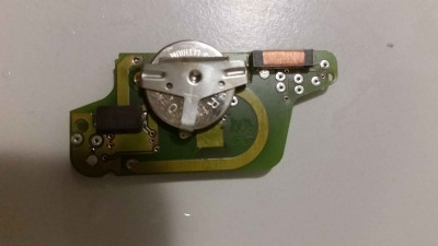

I'm confident replacing the battery does not de-authorise the transponder coded to the ECU.
Is it possible the internal circuit board is now slightly out of alignment inside the case after changing the battery?
I've discovered it only takes barely a millimeter difference to put the transponder just out of range of the ignition ring and fail to communicate. Also check carefully for any dislodged components or tracks damaged on the PCB using a magnifier.

I can't see anything amiss, do you perhaps have any other ideas short of getting it connected to planet peugeot ?
