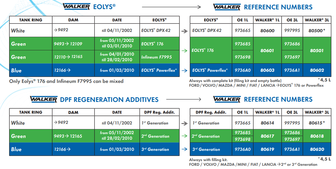

Your Build Number is 11118. So you need Eolys 176.
Walker do an equivalent 1 litre kit (Part 80601), or a 3Lt kit (80501)
You don't need to do any regeneration at a garage - your car regenerates the particle filter as necessary as you are driving without you doing anything. A forced regeneration is not recommended unless really necessary due to the toll it places on system components and the extreme heat generated from the engine.

| Click Fit Colour | RPO | Date | EOLYS |
| White | To 9492 | To 04/11/2002 | EOLYS DPX42 |
| GREEN | 9493 to 12109 | 05/11/2002 to 03/01/2010 | EOLYS 176 |
| GREEN | 12110 to 12165 | 04/01/2010 to 28/02/2010 | Infineum F7995 |
| BLUE | 12166 on | 01/03/2010 on | EOLYS Powerflex |

many thanks as ever for your comprehensive info. I've booked my car in for an Eolys refill next Tuesday so I won't be going many miles over the weekend, and I can happily forget the forced regeneration.
How many litres do you think I might need for this? 3 or more, or less?
One point of clarity: are the regeneration additives something I'll need as well? I've never come across them before.

Hi David - I would get a 3 litre pack as the car's ECU obviously thinks it is low. The 1lt kits are generally for interim top ups. Not sure I understand your next question
- the Eolys 176 (or the Walker equivalent) is the actual additive. You don't need anything else.
