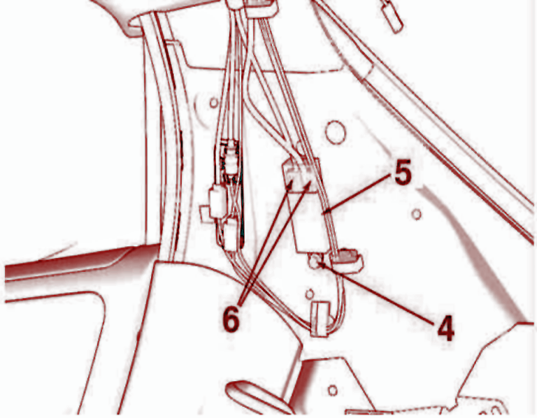

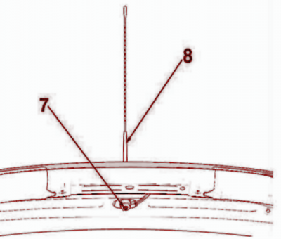

Can anyone enlighten me as to how to change the aerial base on a 207. The radio reception is terrible! I'd like to know if it has a normal co-ax cable going from it to the radio so I can fit a cheap motor factor one if possible. I have an aftermarket radio thanks

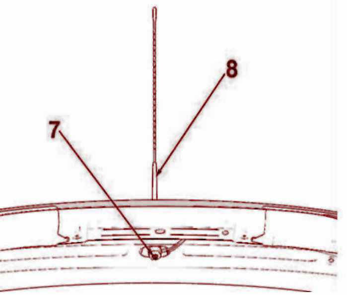

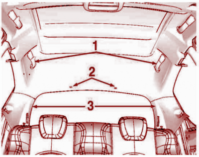

Ok, so on your 207 the base doesn't contain the amplification unit as far as I can see - the aerial unit is stored behind the rear passenger quarter panel (3) as shown in the first Diagram. The unit is number 5 in the second diagram. If you really want to remove the aerial you may have to partially remove part of the headlining to get access.

But I would certainly check with another aerial connected to the back of the radio first to make sure it isn't your radio before going to all that effort.
