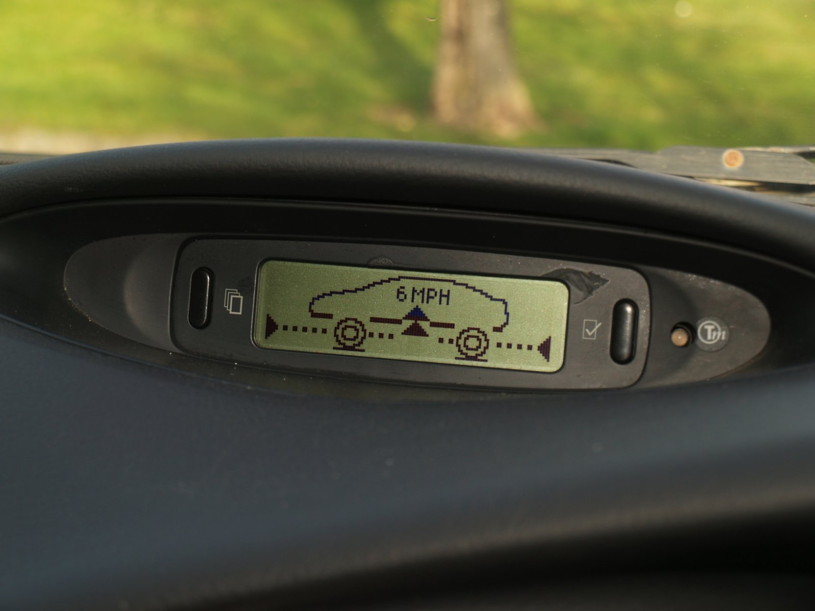

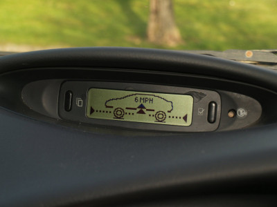

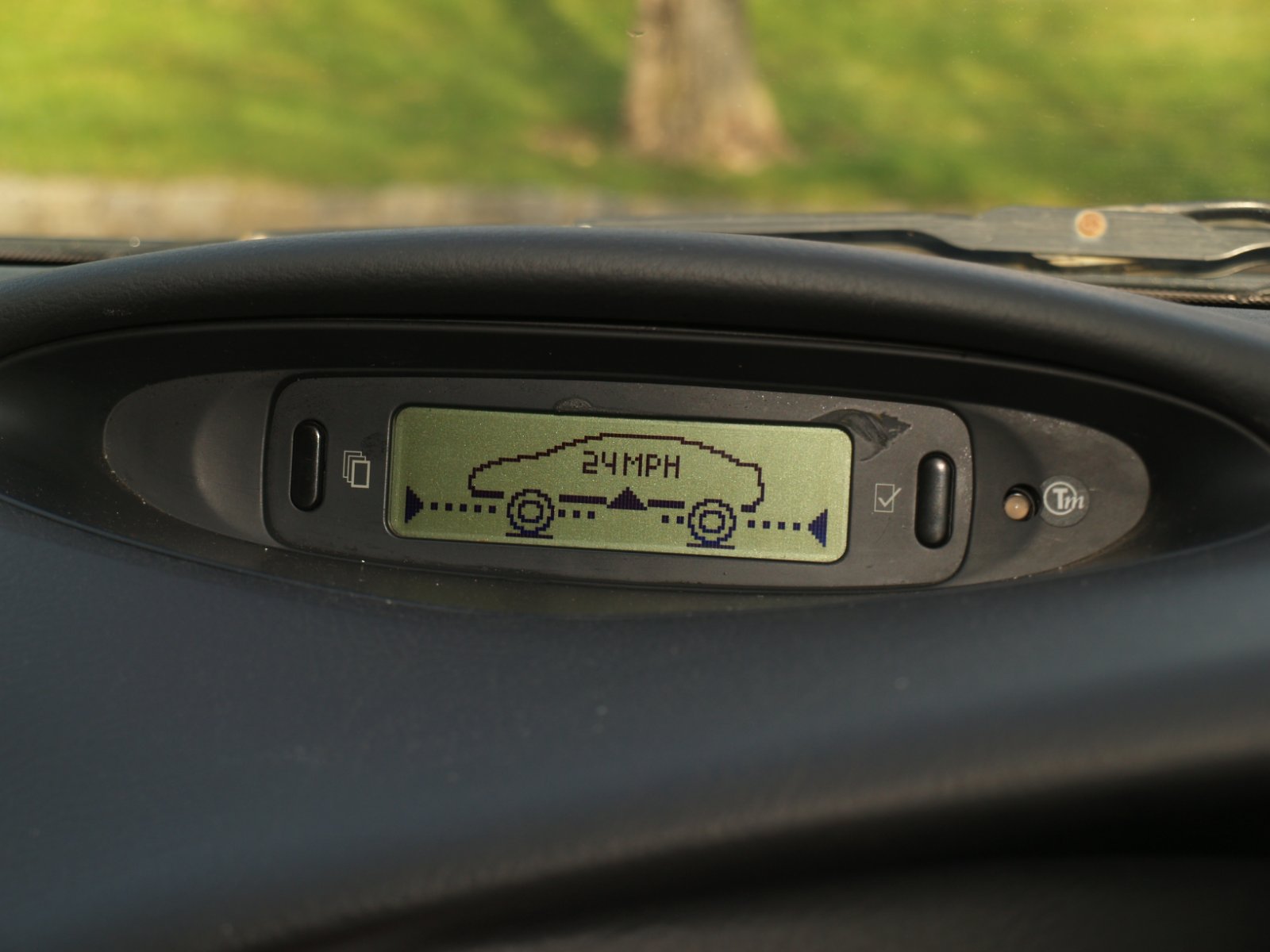

I have a 2007 C5 with Hydroactive suspension but on my instrument panel there is no ground clearance warning lamps so basically I don't know what position the suspension is in , anyone got any idea why this would be please..

Is it not in the central display?
Operate the height buttons and see what it does.
Sometimes can take a few seconds for it to react.
x 6956
Re: Hydroactive suspension question...
Lynyrd Skynner1 wrote: 01 Apr 2019, 09:05 I have a 2007 C5 with Hydroactive suspension but on my instrument panel there is no ground clearance warning lamps so basically I don't know what position the suspension is in , anyone got any idea why this would be please..
The level is displayed on the multifunction screen on top of the dashboard, not the instrument display on MK I and MK II C5s. The display does not permanently display the position of the height setting, only when it has been changed from normal and then only intermittently, unless speed limits are exceeded for the selected height at which point it will lower to normal setting automatically to prevent damage.
Lost the bottom one somewhere :(

Thanks gents will look into that ....

Thank you gents just been out to the car and as you said its all in the display on the dash ......thanks again , another tick on the to do list... :-D
