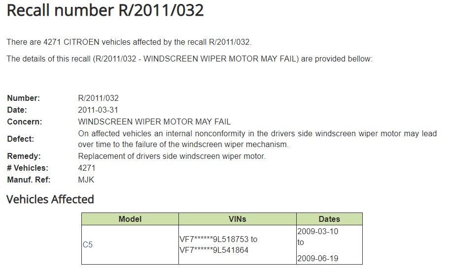

Ok, 2 things - part numbers are below, but I have checked on a recall database and as you can see from the picture below (click to zoom it up), your VIN was within the affected range of recalls for a failing wiper motor. So even though I have entered it on the recall website and it is not returning anything (I believe the VOSA system is useless), sure enough it would seem that using another search that it is is within the range of affected vehicles:
*****9L518753 to
*****9L541864
Your VIN: *****9L535025
So I would definitely tell them your VIN is within the range of recalls as listed on the R/2011/032 recall notice.
Confirmed these are the same part numbers.
Part 6405LE (Left side / UK Passenger side)
Part 6405LA (Right side / UK Driver side)
These retail at £323.75 each inc. VAT. from Citroen.

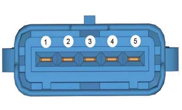

Functions of the driver’s windscreen wiper ECU (master):
5-way yellow connector
Screen wiper (Right hand)
- To receive the wiping speed reference values from the BSI1 on the LIN, via the engine compartment fuse board-fuse box (PSF1)
- To control the driver’s side windscreen wiper motor
- To control the passenger’s windscreen wiper ECU (slave) via the connection between the windscreen wiper motors
| Channel n° | Designation |
| 1 | Supply |
| 2 | Earth |
| 3 | Motor control via relay |
| 4 | Communication between windscreen wiper motors |
| 5 | LIN |

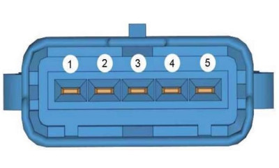

| 1 | LIN |
| 2 | Communication between windscreen wiper motors |
| 4 | Earth |
| 5 | Supply |
