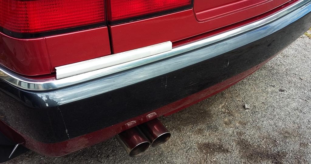

The bumper strips are fastened by tangs that go through button holes in the bumper. Removal is tricky but possible with the bumper off the car, probably with the aid of a little heat.
I need to swap the strip on the rear bumper of my XM from a spare bumper, but I keep finding something more urgent to do.

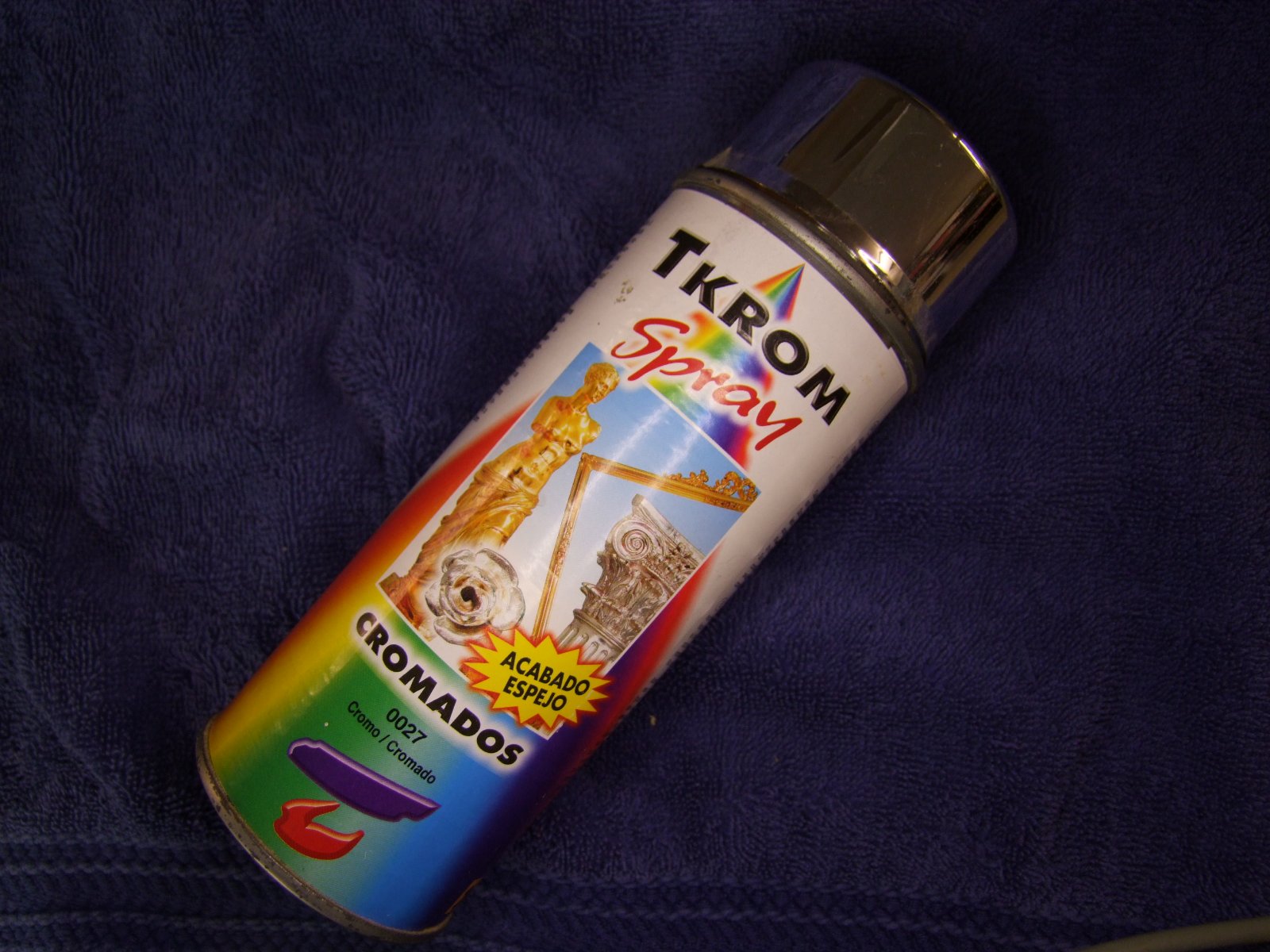

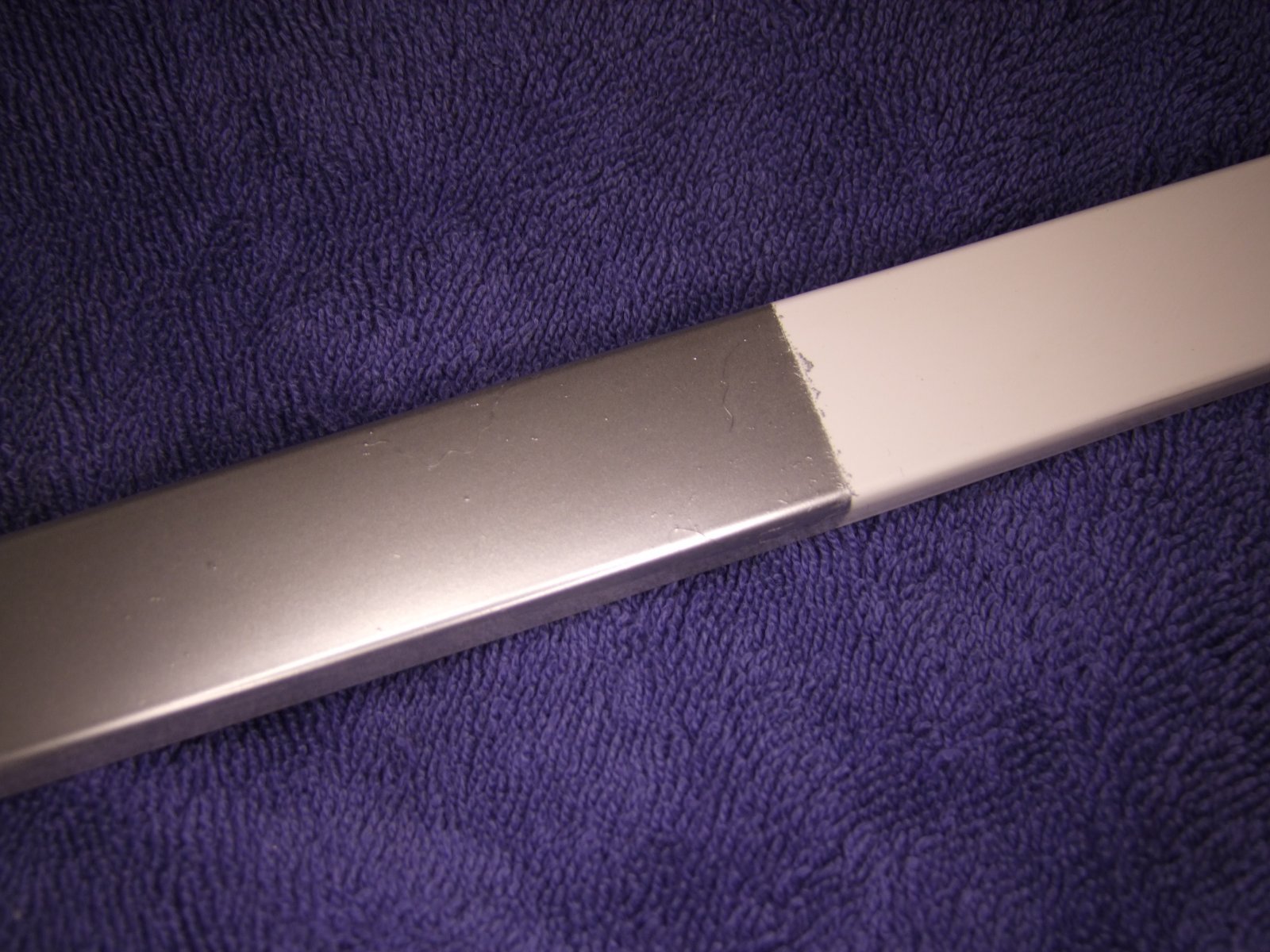

You could consider spray painting the dull chrome strips (in situ) - there are a few 'chrome' aerosols around (like DupliColor). I tested one of these on a piece of plastic some while ago, and it looked promising. This was the result of just one coat...
A clear lacquer coat could be added for protection.
