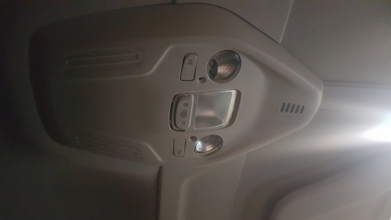

Can anybody shed some light on how to get the bulb out that's gone. I have pulled twisted flat knife.to try n get the cover off to change the bulb. thanks

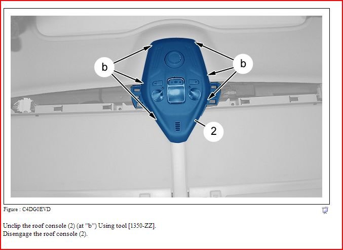

Not sure I can see exactly the arrangement you have but nearest I can see shows that you have to remove the panels extending either side along the top of the screen first (3 clips on each) then there are 3 clips either side of the console.

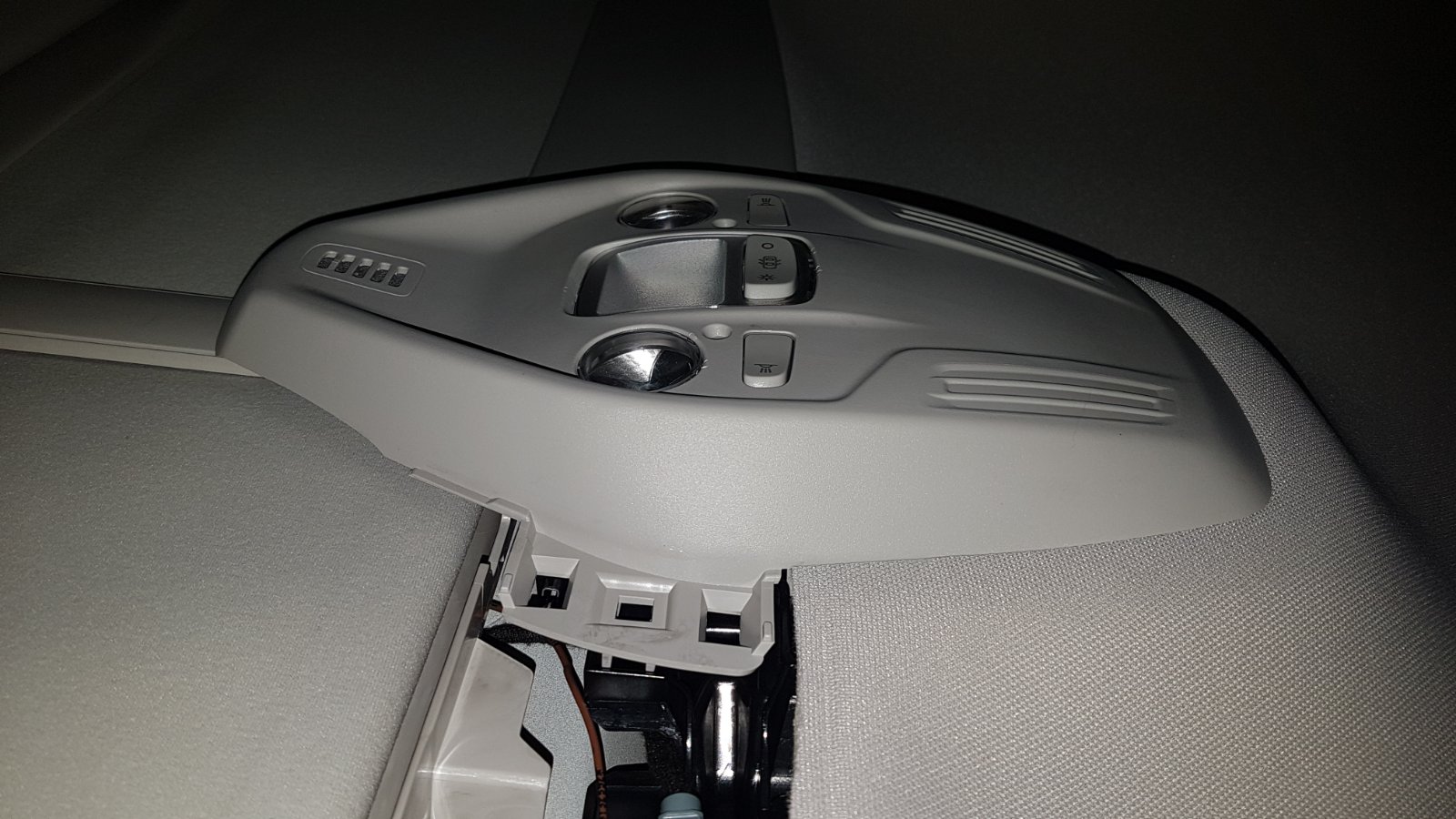

I have got the bit of trim off running longways (see pic) but it still won't come away? Never knew It would be so hard to change a bulb

The tool referred to is just a trim removal tool - you do tend to find that you need to get the tool right in behind the clip to lever them off.
