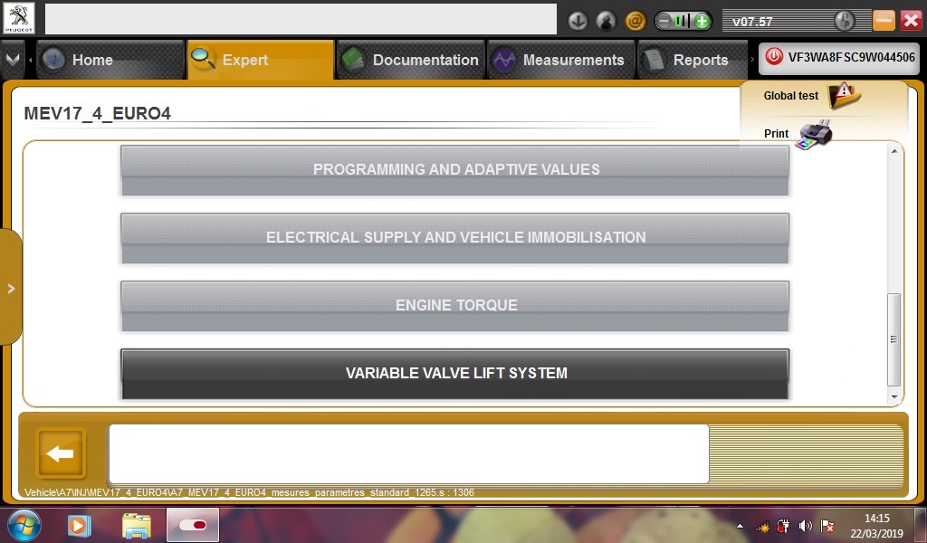

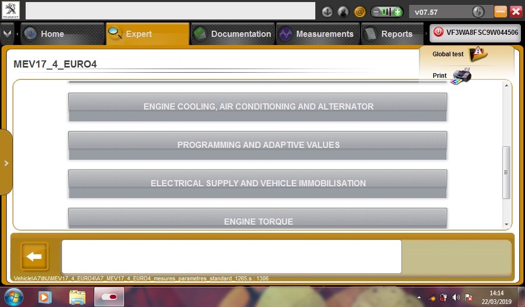

I have diagbox 7.57 running & need to read the fuel rail pressure & crank position sensor but i can't find them anywhere ?

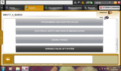

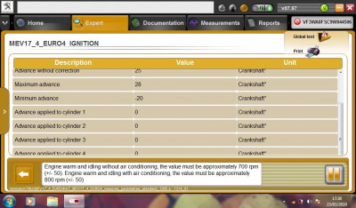

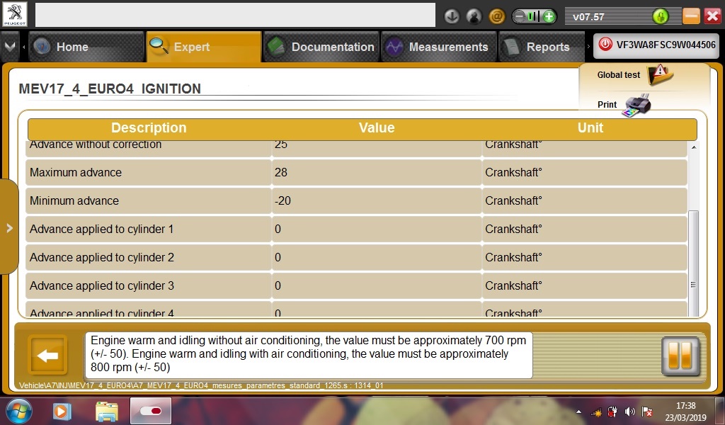

For the fuel pressure if I go into > injection/ignition, then I am offered these options:

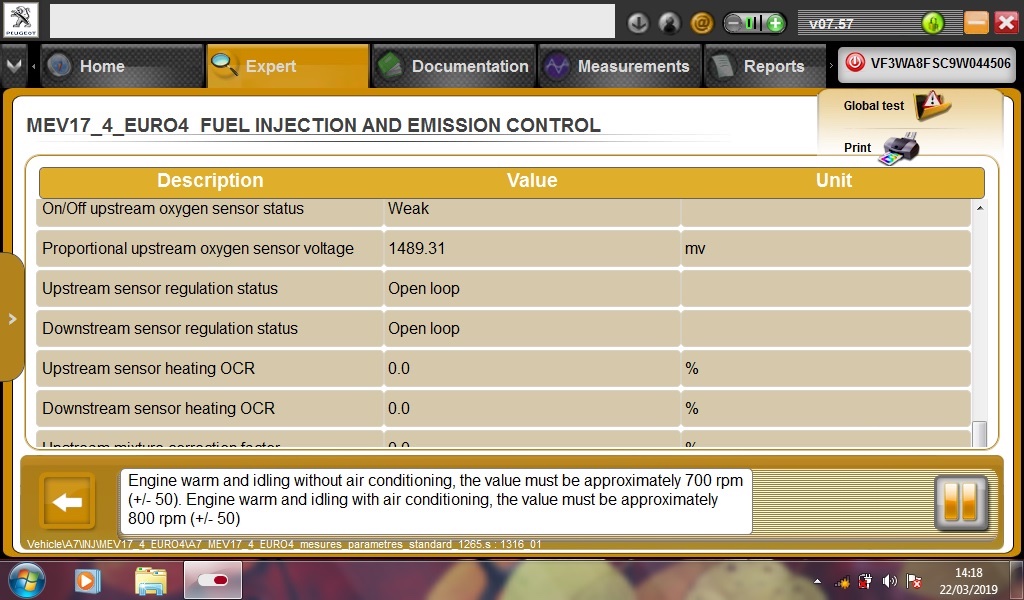

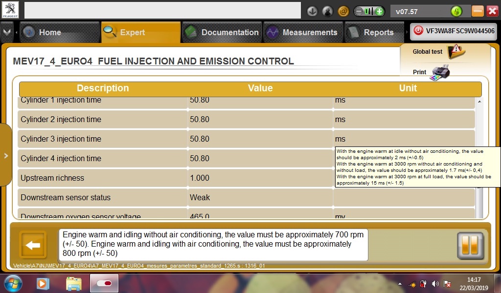

Then if i go into > fuel injection and emission control, there is nothing for fuel pressure:
I've looked everywhere for fuel pressure but can't see it.
Also have looked everywhere for a ckp reading but can't see it.
Have been through every menu in every section i can find including the personalised ones but can't find.
Am new to this so perhaps i am missing something really obvious ?
Thanks

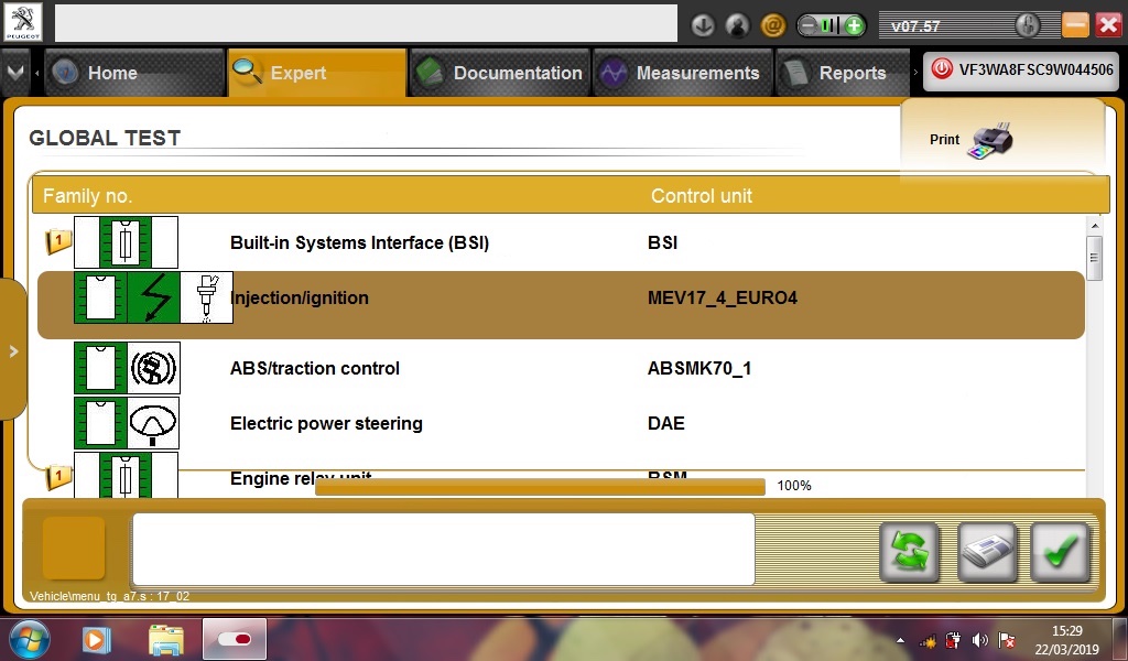

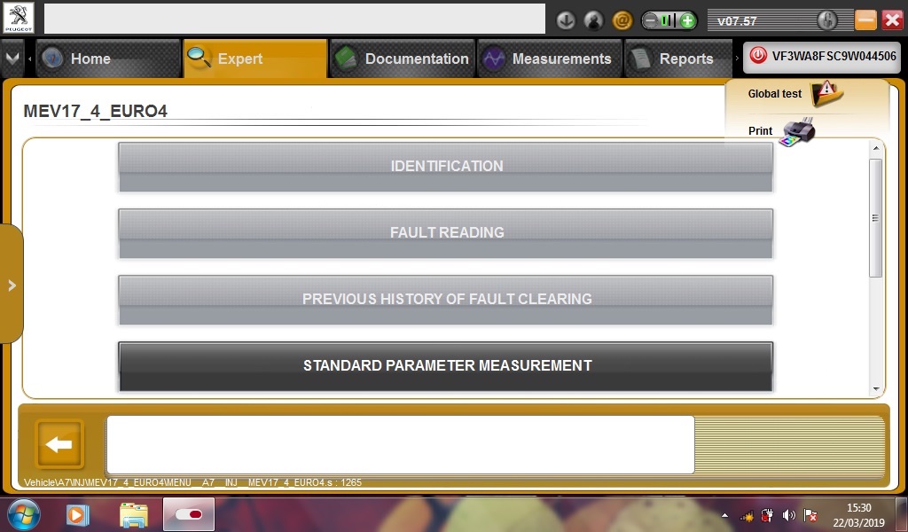

Go into the injection ECU after the global test, then choose standard parameter measurements, then let it load up, then choose IGNITION.

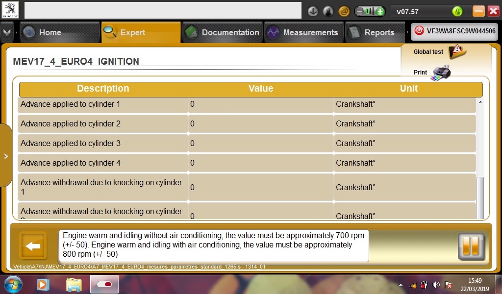

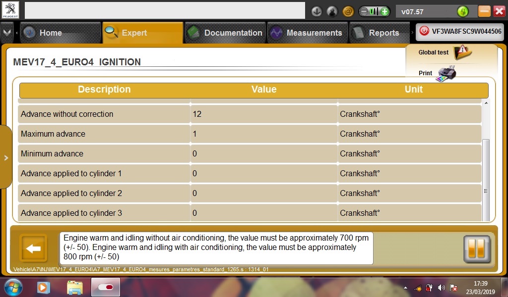

GiveMeABreak wrote: 22 Mar 2019, 15:12 Go into the injection ECU after the global test, then choose standard parameter measurements, then let it load up, then choose IGNITION.
Thanks but there is nothing there.

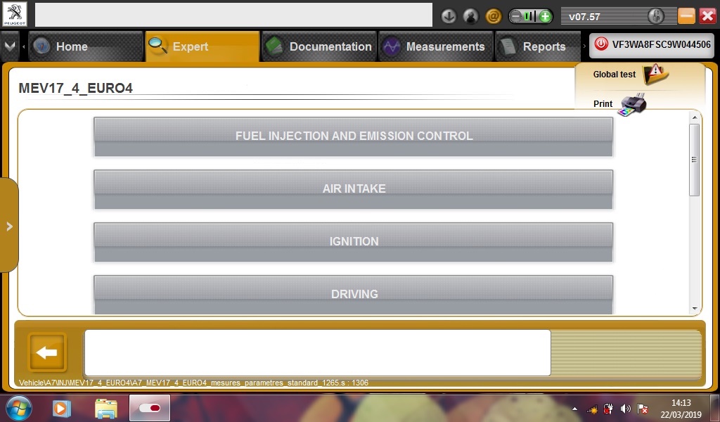

I double click on this: Then click this: Then click on IGNITION & then the next menu only shows this:

Sorry Max - that's what I thought you wanted - crankshaft info? If not what you are looking for, try personalised parameters and see if there is anything more suitable to select. Most of this sort of thing will be in the injection ECU section, but do have a browse about - it is French after all. Just be careful not to change any parameters as there is no undo anywhere!

In the Injection Menu you were in, there is usually a CAMSHAFT option a few lines below the IGNITION option I mentioned earlier (it is under Lexia as opposed to Diagbox). If you have a P0335 fault, this will relate to engine speed fault and can usually be put down to a faulty Camshaft Position Sensor.
The Fuel Rail Pressure should be in the Injection ECU menu there somewhere.

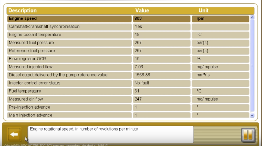

The fuel pressure should be in the standard parameter measurements of the injection ECU. Don't forget to scroll the pages. It is there.

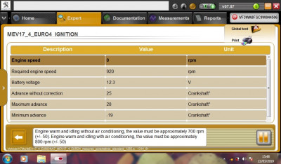

After Global Test completes, go down to the 'Engine ECU' (indicated by a spark plug icon and a Zig zag or similar), and select it. When that loads, go to standard parameter measurements. Then select Fuel Circuit Information, ok the message if necessary and then you'll get all the info:

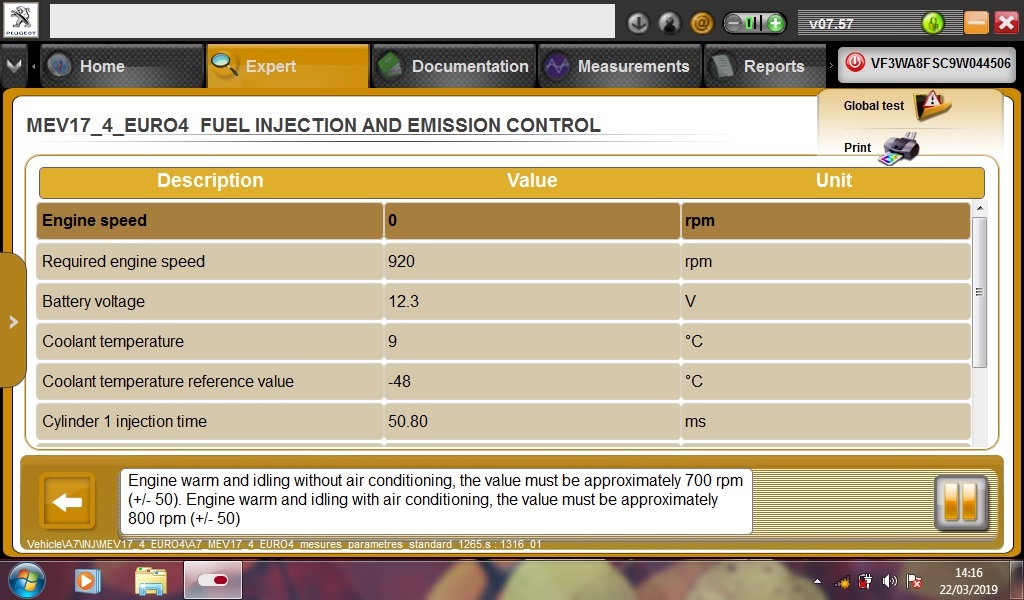

What engine are you talking about? It looks like a petrol to me, in which case the fuel pressure is probably not there. You can see the crank info there, reading zero - crank the engine on that page and see if it changes.

Yes petrol - I forgot! It's a 207 3 DOOR SALOON 1.4 i 16v VVT 95 Manual gearbox 5 Richard.

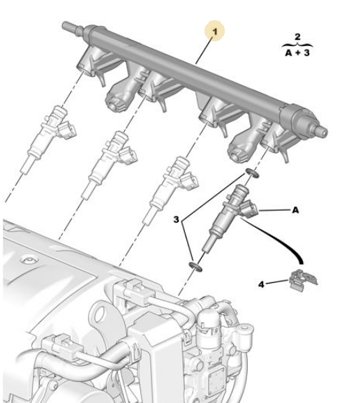

Perhaps they don't supply it for the 'Feed Ramp':

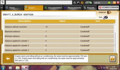

RichardW wrote: 23 Mar 2019, 13:45 What engine are you talking about? It looks like a petrol to me, in which case the fuel pressure is probably not there. You can see the crank info there, reading zero - crank the engine on that page and see if it changes.
Without crank: When cranking:
OnlineRichardW
- Posts: 12596
- x 1489
Re: Diagbox can't find ckp & frp ?
Top of that page, does it show an engine speed when cranking?
