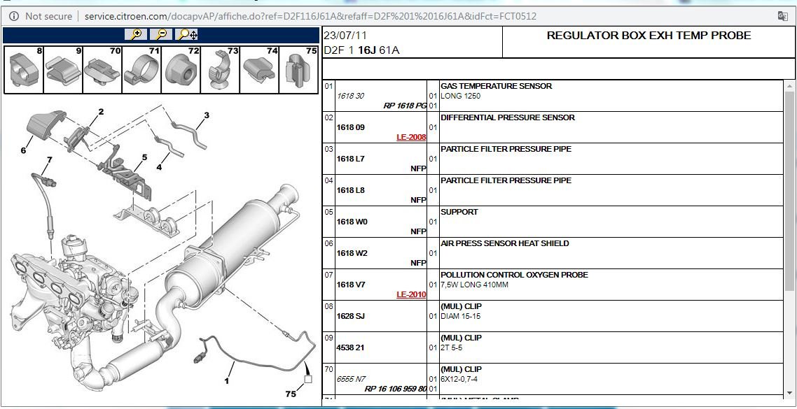

It does appear to have an oxygen sensor:
It should be possible to go into Std Parameter measurements to see what the O2 sensor is doing. I would also look to see what the EGR valve is doing - assuming it has position feedback, then it should closely track the requested position. You could also check the injector corrections to see if any look out of place.
